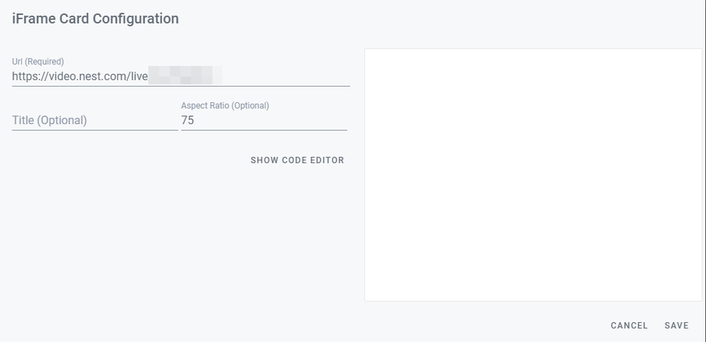

I had been digging around a lot and finally found a way to get the public stream Nest spits out into HA.
Then I also found out you can have a live stream in Lovelace! That’s what I always wanted it to be, so this is even better in my opinion than the true Nest integration as far as video, because the true Nest integration only gave an image every few seconds.
First we need to extract the stream URL out of the public webpage Nest spins up. There’s a utility here to do it, just paste in your public stream and the iSpy (think of it as open source Blue Iris, I was about to use this and still might to do image processing) will spit out the stream URL.
https://www.ispyconnect.com/userguide-nest.aspx
