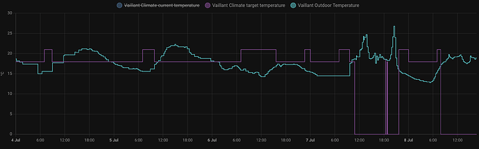

I’ve noticed a change in behaviour (> 0.8.3) which may or may not be intentional:
In versions 0.8.3 (and below) the ā€œclimate targetā€ would track my scheduled temperature (or setback temperature) regardless of whether or not the system had shifted into ā€œecoā€ mode (when the outdoor temperature exceeds the ā€œOT switch-off thresholdā€ temperature preventing the heating from turning on regardless of indoor temperature). Apologies if I’m using the incorrect terminology, perhaps this is more easily explained via a graph:
After the update you can see that when ā€œecoā€ mode kicks in (outdoor temp > 17 C) the ā€œclimate target temperatureā€ shows 0, whereas before it would show the scheduled/setback temperature.
It’s not a big deal, I was just surprised by the change.
Hello Darscan,
I was the one who asked pdd to modify this info in order to highlight the ECO mode and be consistent with what is displayed on the Android application when the outside temperature exceeds the programmed threshold.
Hi @telenaze,
Ah, thank you, I must have missed (or misunderstood) that request.

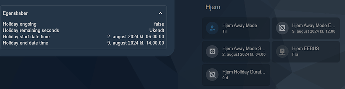

I think there is something wrong with away mode, when i set the time, it jumps in time and date.
and
when it type in the right time in the app. the atribute on ā€œHome away modeā€ is 2 hours off.
The right time in the app is on the right side
