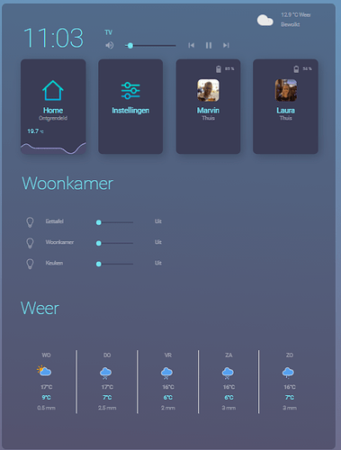

thanks for the encouragement, have been working on this since yesterday and am slowly getting there! there really is no better way to learn than by doing. My formatting is still a bit off, but for now i’m just trying to figure out what i want where and how to get various elements in. so far i’ve added a camera feed to where your calendar section is, and a section for dishwasher controls which i’m pretty pleased about.
I have a couple questions though, if you don’t mind? :slight_smile:
For the bottom Lighting section, is it possible to add groups of lights to the vertical sliders? I tried this but it keeps breaking the formatting - when i put in a single light entity it works as expected.
Secondly, I have Sonos speakers littered around my house rather than chromecast devices, is there any way you know to send spotify playlists to these? i tried to google it but i just get results for mini-media-player, which is great!, but it only lets you define a master player for each card, rather than let you pick which speaker you want to play on… at least as i understand it.
Thanks again for sharing your code. It’s incredibly impressive that you managed this in just 2 months. i’m honestly in awe.

Thanks for the pointers, it’s starting to look amazing already:
And the sliders:
The only downside of the sliders is that it is really hard to control them on a tablet when they are inside a swipe card, have you found a solution for that yet?
