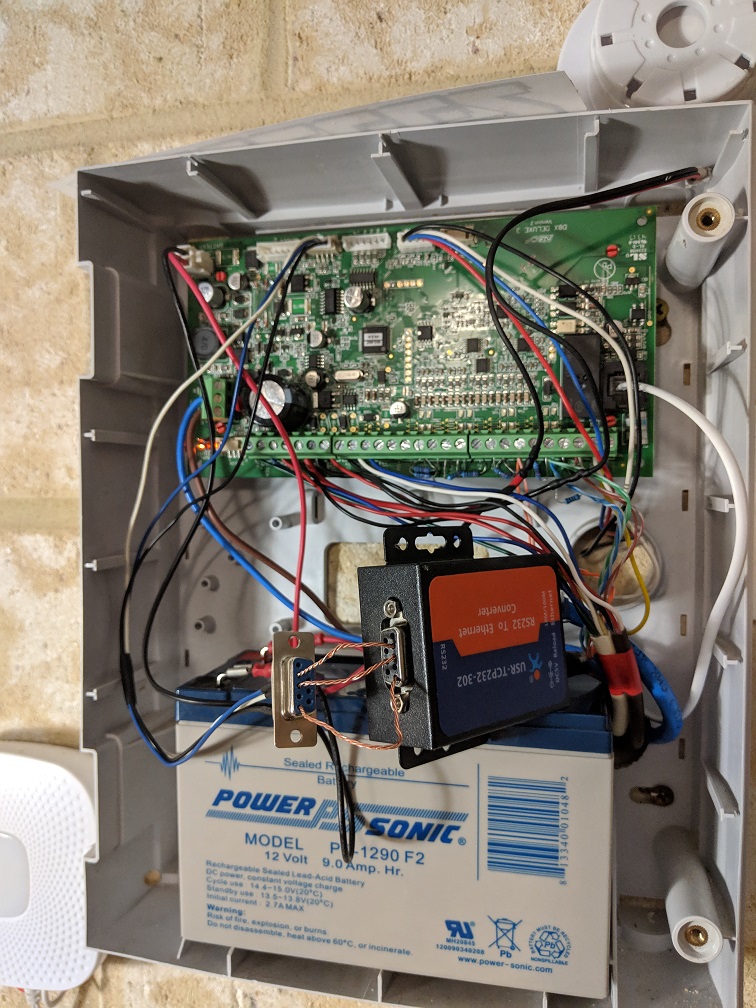

Have a general question about the USR-TCP232-302. If anyone recalls I have been having the issue where everything I send to it bounces back. Also I have found that I can only receive info from the NESS panel. That is I can see the PIRs detect movement. I can see when I arm and disarm the panel at the physical keypad but if I ask to arm or disarm through HA nothing happens. I have checked the three wire cable I have and there is continuity there. Anything else I can do to fault find this. Could the converter be the issue?

Just tried a new TCP232 and same problem as before. So I am guessing either the panel has some software or hardware issue that is preventing it from receiving commands…
Have you tried directly connecting to a pc without the converter?
No I havent. I can try that and see what I get out of it. Might take a few days to get around to it.

I am yet to look at it again but the other issue I had was when I bought the three wire serial cable I had to swap the cables around to get it to work. I assume I have it correct now since I can receive commands but it is something I wanted to check further.

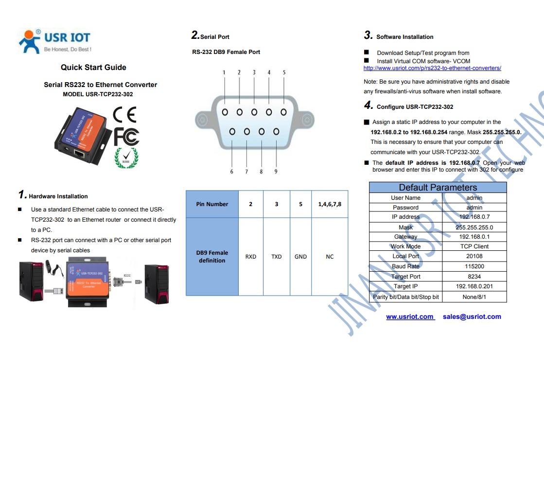

excuse my dodgy jumper wires, but the female rs-232 DB9 pins on the USR-TCP232-302 are pins 2,3 and 5 correct?
The ethernet convertor seems to be working fine, but I cant seem to get the windows based nesscomms software (v5.7.0.0) to work over a virtual com port. ā€œERROR: Product not communicatingā€
It is a brand new d8x deluxe panel. I’ve got 9600,8,N,1 and then LINK and ā€˜Similar RFC2217’ set on my USR-TCP232. Panel is in installer mode.
Just wanted to confirm my pinouts were ok?. Cheers
No I think you have got it back to front havent you?
Db9 Female Wiring | Wiring Diagram
https://images.app.goo.gl/uJ5WK7DpuAGivs2U8
yeah, that is what I thought. However the USR guide says the opposite. I will keep trying some different combinations and report back. What have others with the USR branded converter done to bridge the female serial ports?
