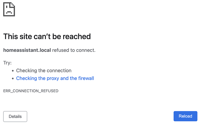

Curiously, I can access Home Assistant Observer on http://homeassistant.local:4357/ and receive messages of Connected, Supported, and Healthy.
When I attempt to connect to Home Assistant at http://homeassistant.local:8123/, I receive a ERR_CONNECTION_REFUSED response. I’ve tried both Chrome and Safari, and both provide the same results. Can someone please help me understand what’s going on?

Same result. I can get to Observer with IPADDRESS:4357, but I get ERR_CONNECTION_REFUSED when I try to go to IPADDRESS:8123.

I thought this, too, but you can imagine my surprise to find that http://[fd6e:7763:6711::862]:4357]/ DOES appear to reach my Home Assistant NUC and show me a good Observer status. Replacing :4357 with :8123 gives me a connection refused (as if the port is not open) rather than a host unreachable (no device found at this IP address) error. That’s what seems incredibly strange to me.
