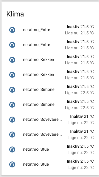

Just to note, I have 2 entities for each valves, I don’t remember if it was a knows issue.
Regards,
Laurent
Probably a little bug linked to the fact I have two homes because of my Netatmo camera and discovery true …
If I put discovery false and set the home manually, no more double entities.
BAM… on first reboot it does not work, on second reboot IT WORKS!!
But I have every valve 2 times…? (found by autodiscover)
