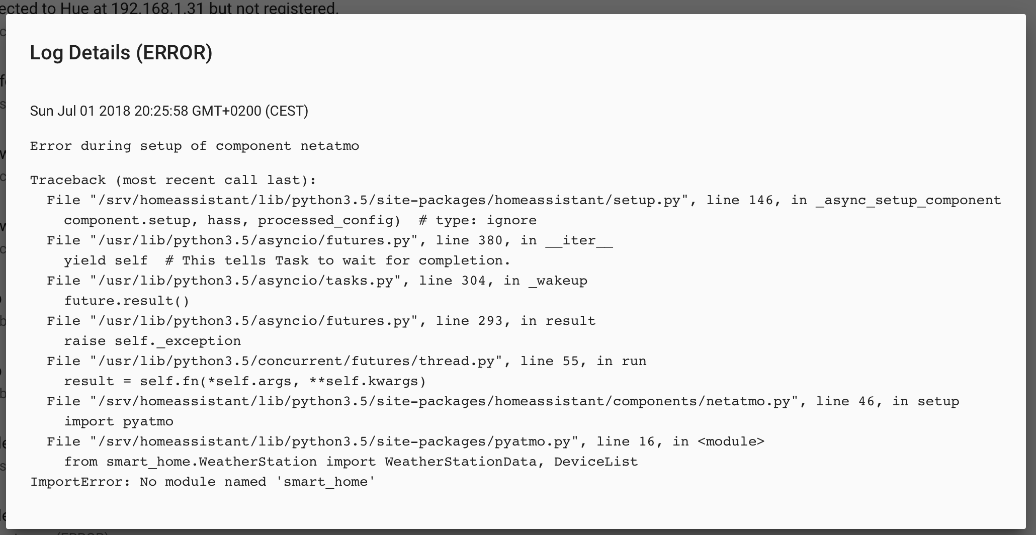

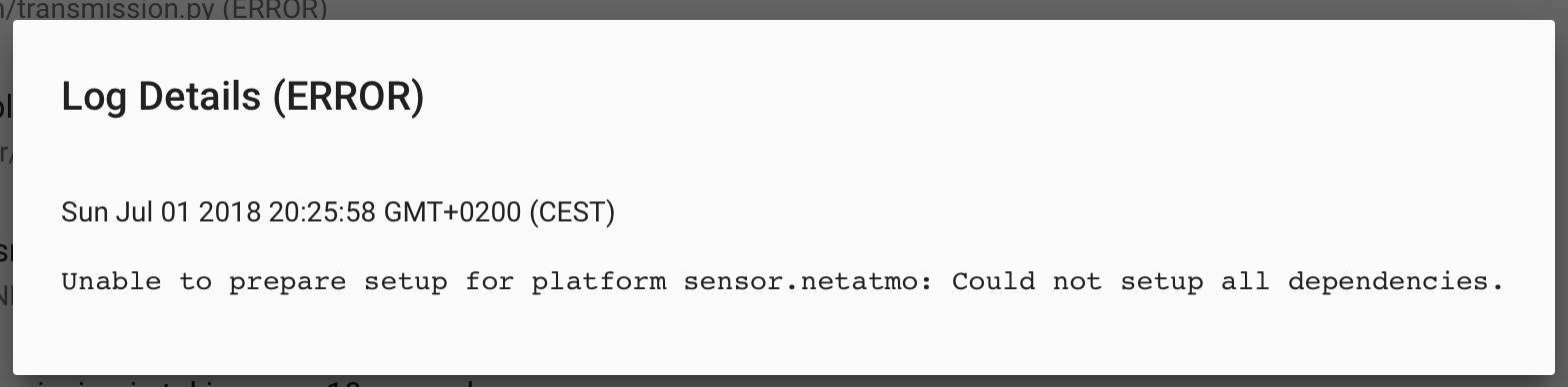

same problem. I tried to reverse the api key and the secret key between netatmo and netatmo2 but I get the following errors
I see the two thermostats correctly through netatmo2

@p3xx69
@CapitanoNemo
try to delete the pyatmo library
/site-packages/__pycache__/pyatmo.cpython-35.pyc
/site-packages/pyatmo-1.0.dist-info
/site-packages/smart_home
/site-packages/pyatmo.py
and reboot
