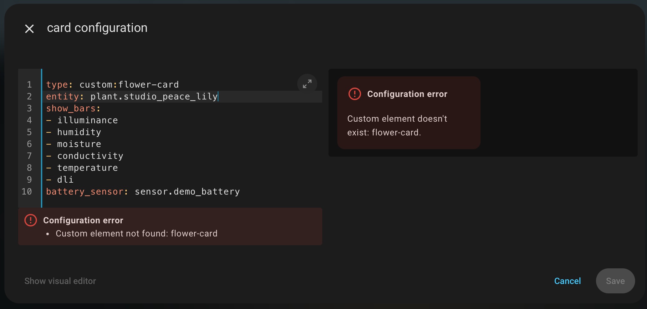

It seems like this Flower Card doesn’t work with latest version of HA 2025.8.3
I can find it in HACS and install it and then it disappears. I tried installing it manually but that also doesn’t help it.
My Dashboard thinks it doesn’t exist.
I really would like to have it work.
@Olen Do you think you’ll be looking into it again? I know how annoying it must be to keep these things updated all the time.
It’s working fine for me, both when I was on HA 2025.8.x and now on 2025.9.0b1
It might be your indentation. See mine:
type: custom:flower-card
entity: plant.lady_finger_palm_left
battery_sensor: sensor.lady_finger_palm_left_ble_plant_sensor_battery
show_bars:
  - moisture
  - conductivity
  - temperature
  - illuminance
