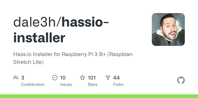

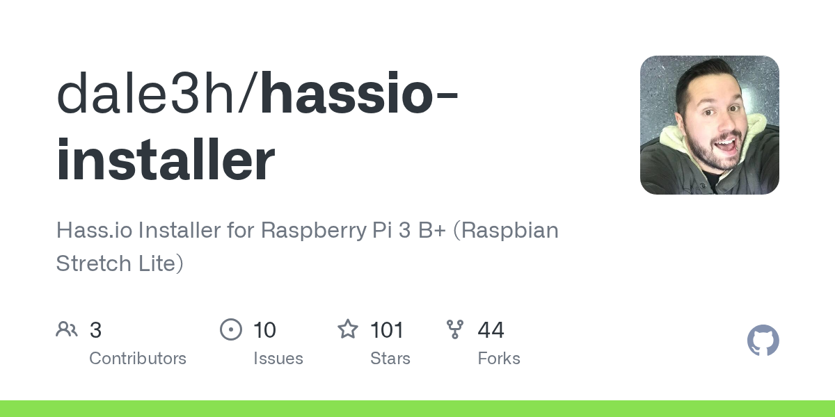

You’re getting confused between installing hass.io and installing home assistant in docker. If you see supervisor, it means you installed hass.io @flamingm0e is not a ‘fan of using hass.io and prefers home assistant in docker. My preference is running hass.io in docker so I get all the addons as part of hass.io and managed in hass.io. Whereas the alternative requires you to install seperate docker containers and manage the relationships between them all so they can talk to each other. Neither approach is wrong they are just different approaches and you are tying yourself in knots as you don’t really understand the differences.
I did use the script by Dale3h to install hass.io in docker and was really happy with it.
Well thanks yeah, the confusion was initially there, but if you see the progression of the thread it is sorted out, and I removed an earlier home assistant docker container/images to go the hass.io way. For Hass.io (docker container apporach), i read the thread where even @flamingm0e relplied himself .
Hass.io via Docker
This is my preference too, hence I am trying to go this way. You can see all above installation approaches and screenshot to substantiate my claim
Absolutely , althgouh a more Pro approach, this way would require extended learning and learning all nuts and bolts, which may come after a while if I get a quick working start and some initial success.
Can you please point the link to this script, and before running it, I assume I should remove all previous container/script to start afresh.
Thanks for your responses.
Ok found it , is it the one ?
The only difference is I am not (niether do I want to) start from a new Raspbian Stretch Lite image, I already have the latest Jessie running, would it make any difference or break of functionality. ?
Thanks.
