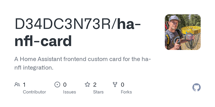

@D34DC3N73R has also built a wonderful lovelace card showing the details for a game in a very nice made-for-TV type of way. The card relies on the custom component above.
Example:
