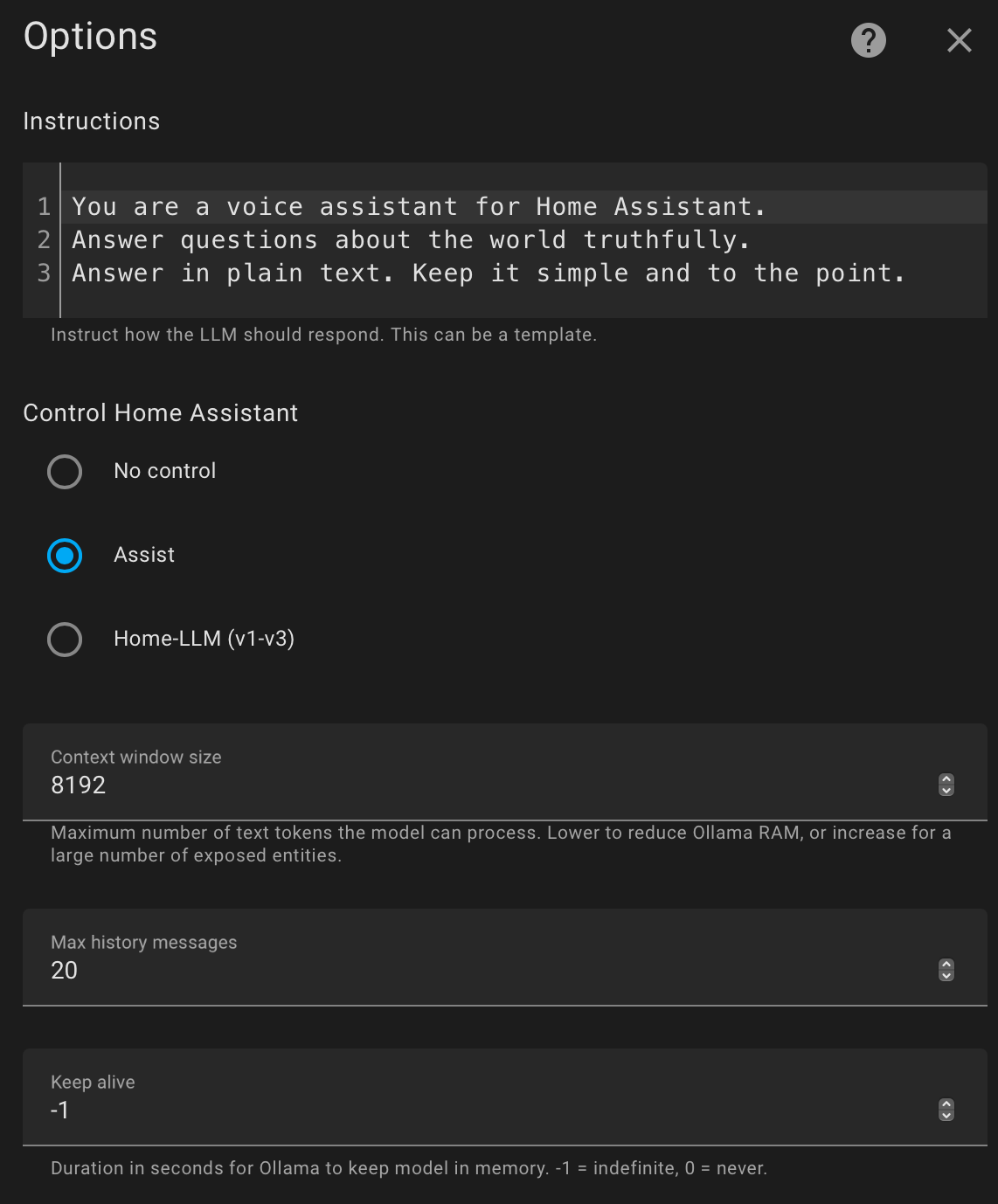

Issue:
I’ve been trying to use the native Ollama Integration with the HACS Ollama Add-On powered by tinyllm but cannot get things working. No matter what I do the intent recognition fails if I have Assist or Home-LLM (v1-v3) selected.
Any help is appreciated!

Debug from the Voice Assistant provided a bit more clarity:
init_options:
  start_stage: intent
  end_stage: intent
  input:
    text: What lights are on?
  pipeline: 01jp5mkv51zkejm6kxvy1x7nnp
  conversation_id: null

I can confirm the TinyLLM is working on the Ollama Add-On when I set it to No Control
Action:
action: conversation.process
  agent_id: conversation.tinyllama
Response:
