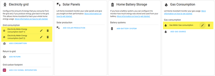

Did you already set up your Energy dashboard as well? If you open it on the left bar, then you can set Electricity and gas meter consumption entities, and production if applicable. When set, Home Assistant will make up an energy dashboard with diagrams.
see: Energy Cards - Home Assistant
Yes, so far, I set like this below (I don’t have solar panel / battery / etc.). I hope that’s correct :slight_smile:
Any tips or things I can change/add?
no, no changes. It’s just fine like this. :wink:
