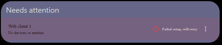

im getting this error
can anyone here assist with it please <3
Is there any additional detail if you mouse over the error message? You can also check out SettingsSystemLogs to see error information about why its failing to setup. See Troubleshooting your configuration - Home Assistant for even more details.
It may be worth forking a separate discussion thread given that this is unrelated to the topic in this thread about the redirect_uri error when configuring the integration.
