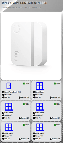

Sorry for my late response, I’ve been busy with some other work.
First of all here is a full view of my Alarm Dashboard. Here below I will put the code. You will need the Mashroom Lovelace theme + Card- mod (frontend in HACS) + Alarmo (integration in HACS).
When someone is detected by a senssor or if a window is open, then the corresponding card will light in orange. I also collect some information for each senssor, such as battery life time, the name, status etc…
Here below the code for part 1:

Here below the code for part 2:
type: vertical-stack
cards:
  - type: horizontal-stack
    cards:
      - type: custom:mushroom-title-card
        title: RING ALARM SIREN
        subtitle: >-
          Tamper:  {% if is_state('binary_sensor.sirene_exterieure_tamper',
          'off') %}ok {% else %} Not ok {% endif %}
    cards:
      - type: custom:stack-in-card
        cards:
          - type: custom:mushroom-entity-card
            entity: number.sirene_exterieure_volume
          - type: picture
            image: /local/images/ring_sirene_ext2.png
            tap_action:
              action: none
            hold_action:
              action: none
          - type: custom:bar-card
            severity:
              - color: Red
                from: 0
                to: 20
              - color: Orange
                from: 21
                to: 50
              - color: lightGreen
                from: 51
                to: 100
            icon: mdi:battery
            columns: 4
            height: 40
            value: outside
            entities:
              - entity: sensor.sirene_exterieure_battery

                  "off") return  "blue"; ]]]
            info:
              - padding-bottom: 2px
              - align-self: bottom
              - justify-self: start
              - '--text-color-sensor': >-
                  [[[ if
                  (states["sensor.ring_motion_sensor_entrance_battery"].state >
                  80) return "red"; ]]]
            tamper:
              - justify-self: end
                  [[[ if
        custom_fields:
          battery_wifi: |
              var battery = (states['sensor.ring_motion_sensor_entrance_battery'].attributes.batteryLevel);
              var battery_icon = (states['sensor.battery_percentagering_motion_sensor_entrance_template'].attributes.icon);
              var battery_icon_color = states['sensor.ring_motion_sensor_entrance_battery'].attributes.batteryLevel > '30' ? 'green' : 'red';
              return '</ha-icon> <ha-icon icon="' + battery_icon +'" style="width: 20px; height: 20px; color:' + battery_icon_color +';"></ha-icon>'
              + battery + '%'
              return `<ha-icon
                icon="mdi:rename-box"
                style="width: 19px; height: 19px; color: rgb(0, 0, 0);">
                </ha-icon><span>Name: <span style="color: rgb(0, 0, 0);">EntrƩe RDC</span></span>`
          status: |
              return `<ha-icon
                icon="mdi:information"
                </ha-icon><span>Status: <span style="color: rgb(0, 0, 0);">${states['binary_sensor.ring_motion_sensor_entrance'].state}  </span></span>`
          info: |
              return `<ha-icon
                </ha-icon><span>Info: <span style="color: rgb(0, 0, 0);">${states['sensor.ring_motion_sensor_entrance_info'].state}</span></span>`
          tamper: |
              return `<ha-icon
                icon="mdi:hand-back-left"
                </ha-icon><span>Tamper: <span style="color: rgb(0, 0, 0);">${states['binary_sensor.ring_motion_sensor_entrance_tamper'].state}</span></span>`
      - type: custom:button-card
        entity: binary_sensor.ring_motion_sensor_salon
        icon: mdi:motion-sensor
        show_name: false
        styles:
          card:
            - background-color: |
                  if (states["binary_sensor.ring_motion_sensor_salon"].state == 'on') return 'rgb(255, 183, 18)';
                  else return 'rgb(227, 228, 230)';
            - padding: 5%
            - color: black
            - font-size: 12px
            - font-weight: bold
            - text-transform: capitalize
          grid:
            - grid-template-areas: '"i battery_wifi" "name name" "status status" "info tamper " '
            - grid-template-columns: 1fr 1fr
            - grid-template-rows: 1fr min-content min-content min-content
          img_cell:
            - justify-content: start
            - align-items: start
            - margin: none
          icon:
            - color: |
                  if (entity.state == 'off') return 'blue';
                  else return 'red';
            - width: 70%
            - margin-top: '-5%'
          custom_fields:
            battery_wifi:
              - align-self: start
              - justify-self: end
            name:
            status:
                  [[[ if (states["binary_sensor.ring_motion_sensor_salon"].state
                  == "off") return  "blue"; ]]]
            info:
                  [[[ if (states["sensor.ring_motion_sensor_salon_info"].state >
            tamper:
              - justify-self: end
        custom_fields:
          battery_wifi: |
              var battery = (states['sensor.ring_motion_sensor_salon_info'].attributes.batteryLevel);
              var battery_icon = (states['sensor.battery_percentagering_motion_sensor_salon_template'].attributes.icon);
              var battery_icon_color = states['sensor.ring_motion_sensor_salon_info'].attributes.batteryLevel > '30' ? 'green' : 'red';
              + battery + '%'
              return `<ha-icon
                </ha-icon><span>Name: <span style="color: rgb(0, 0, 0);">Salon</span></span>`
          status: |
              return `<ha-icon
                </ha-icon><span>Status: <span style="color: rgb(0, 0, 0);">${states['binary_sensor.ring_motion_sensor_salon'].state}  </span></span>`
          info: |
              return `<ha-icon
                </ha-icon><span>Info: <span style="color: rgb(0, 0, 0);">${states['sensor.ring_motion_sensor_salon_info'].state}</span></span>`
          tamper: |
              return `<ha-icon
                </ha-icon><span>Tamper: <span style="color: rgb(0, 0, 0);">${states['binary_sensor.ring_motion_sensor_salon_tamper'].state}</span></span>`
Code to add in the configuration section
In my configuration file I call a file named ā€œsensorā€, maybe you have the senssor section directly in the configuration file. So just be careful where you paste the following code. Also I’m just giving two as an example, because you just have to repeat the process for all of your sensors.
# Ring Alarm Sensor's battery levels
- platform: template
  sensors:
    battery_percentagering_motion_sensor_chambre_rdc_template:
      value_template: >-
        {{ state_attr('sensor.ring_motion_sensor_chambre_rdc_battery','batteryLevel') }}
      icon_template: >-
        {%- set batteryLevel = state_attr('sensor.ring_motion_sensor_chambre_rdc_battery','batteryLevel') -%}
        {% if batteryLevel <= 30 %}
          mdi:battery-alert
        {% elif batteryLevel > 30 and batteryLevel <= 40 %}
          mdi:battery-30
        {% elif batteryLevel > 40 and batteryLevel <= 50 %}
          mdi:battery-40
        {% elif batteryLevel > 50 and batteryLevel <= 60 %}
          mdi:battery-50
        {% elif batteryLevel > 60 and batteryLevel <= 70 %}
          mdi:battery-60
        {% elif batteryLevel > 70 and batteryLevel <= 80 %}
          mdi:battery-70
        {% elif batteryLevel > 80 and batteryLevel <= 90 %}
          mdi:battery-80
        {% elif batteryLevel > 90 %}
          mdi:battery
        {% endif %}
  sensors:
    battery_percentagering_motion_sensor_salon_template:
      value_template: >-
        {{ state_attr('sensor.ring_motion_sensor_salon_info','batteryLevel') }}
      icon_template: >-
        {%- set batteryLevel = state_attr('sensor.ring_motion_sensor_salon_info','batteryLevel') -%}
          mdi:battery-alert
          mdi:battery-30
          mdi:battery-40
          mdi:battery-50
          mdi:battery-60
          mdi:battery-70
          mdi:battery-80
          mdi:battery
        {% endif %}
Here below the code for part 5:
This is exactly the same as Part 4, so I will not add it here.
I Hope this process is clear for all of you. Please ask questions if you have any. I’ll try my best to reply in time.
Thank you so much, that’s really complete :smiley: !!
You are really welcome and please do not hesitate if you have any question or if I forgot somthing.
