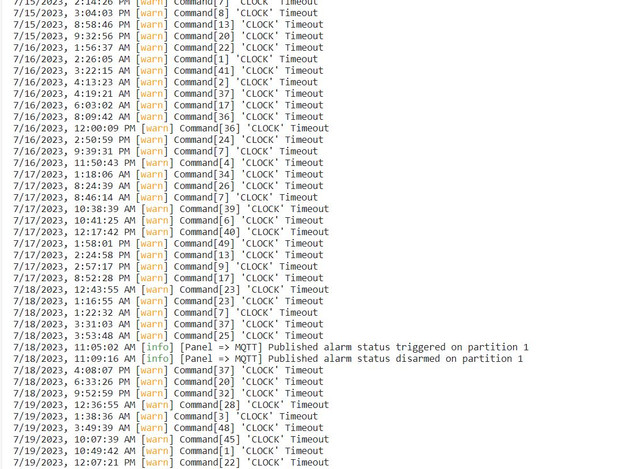

This week we had a false alarm… however, HA didnt do anything, although i configured automations…
The automations work, cause when i change the state manually of a binary sensor, then the automations doest it programmed stuff.
So no fault there.
However, i think the Risco isnt passing through the states…
When i look into the log, i see this:
are you using the cloud/proxy in that addon? i had the same issue, had to restart the addon
not sure, how can i see again, been a long time…
think cloud
just restarted it
buyt it should be stable, especially for fire…
cant risk not working
You can see it how you configured it…
