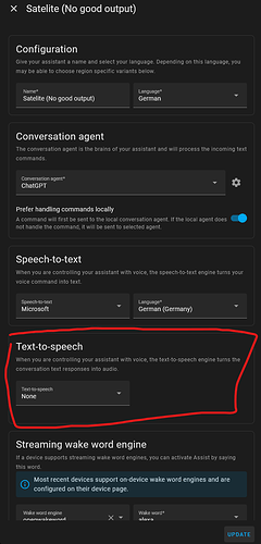

In order to not waste any ressources on the output on the satelite I configured an Assistant that uses no output. Don’t forget to add the wakeword in the three dots menu :slight_smile:
[NEW USERS CAN ONLY EMBED A SINGLE GRAPHIC - REMOVED]
Change the satellite config in the Integration:

Hi, how did you made to mute the wyoming satelite locally?
I created a special assistant in the Assistant menu and simply removed text-to-speech like this:
Good luck!
