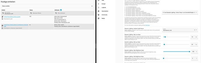

Hm, weird. I did update the blueprint before coming here. You can ignore the etc, that’s my bad – I felt like shortening my YAML, it just stands for et cetera. Here’s the full YAML (note I changed the lux sensor to a different one, but that doesn’t help):

Is there a way I can better debug this? The trace is huge. I’m a developer but this is giving me a headache haha. I can see in the trace that the lights are being turned on. I’ve also found the step in which the brightness is calculated, but unfortunately Home Assistant doesn’t seem to log the individual variables used in this template.
@korlaar
Hi Max,
This can be frustrating… sorry to hear you having trouble with it :pensive: The trace will only show you the Iteration steps… what brightness and transition is being applied on each heartbeat.
I used your YAML you provided (current one). The only things I changed are the trigger, lights (added 3 lights in), LUX sensor and the toggle helper. It all worked perfectly. So lets say your settings are all good.
Lets try a few things to work out what it may be!
  1. The automation is being triggered so we know that works but if you like create another toggle helper and add that entity to your trigger (copy paste the entity ID in). That way you can easily run the automation. You will know when you toggle it ON it is ON.
  2. Try One light you know that works and know that brightness can be changed in home assistant. Edit: You can also try not using dynamic lighting (disable it) and turn you light ON and OFF with the automation changing the brightness value each time in the Light Control. Check you lights are responding to your set points.
  3. This is where I think it may be… your lux sensor… you tried another one but do you have a temperature sensor? It is numeric state so it will work with temperature sensor or any sensor that has a number value. If you got one copy and paste the entity ID into the input. You may have to adjust your LUX settings to suit the temp sensor.
  4. The Dynamic Lighting - Toggle Helper this should be all good but make sure you are only using it in this blueprint and nothing else.
Hopefully you will find what is the problem.
Blacky :smiley:

Great, this confirms again that the blueprint is working correctly and the setup is identical across rooms.
:thinking: Just because it worked before doesn’t entirely rule out the possibility. Was something else triggering it back then? Is this light bulb connected to anything else? If you swap it to another room with the same blueprint, does it still turn on at 0:33 am or 0:45 am? Maybe Home Assistant isn’t fully controlling it? Ikea gateway? It could just be that light bulb is faulty now. Can you factory reset it?
I would focus on the actual light bulb. There could be other factors at play, such as hidden triggers or overlapping automations. It might be worth reviewing all related automations and integrations.
Also, check the Logbook to see what triggered the light. You can use the Trace feature in automations to follow the exact flow and see what caused the light to turn on.
If the same brand of light works correctly in other rooms, it might not be an issue with Home Assistant. Check if the problematic bulb is running the same firmware version as the others, if possible.
I haven’t encountered this specific issue before, but it’s possible someone else has.
Hopefully, this helps you resolve the issue. Let us know what you find out.
