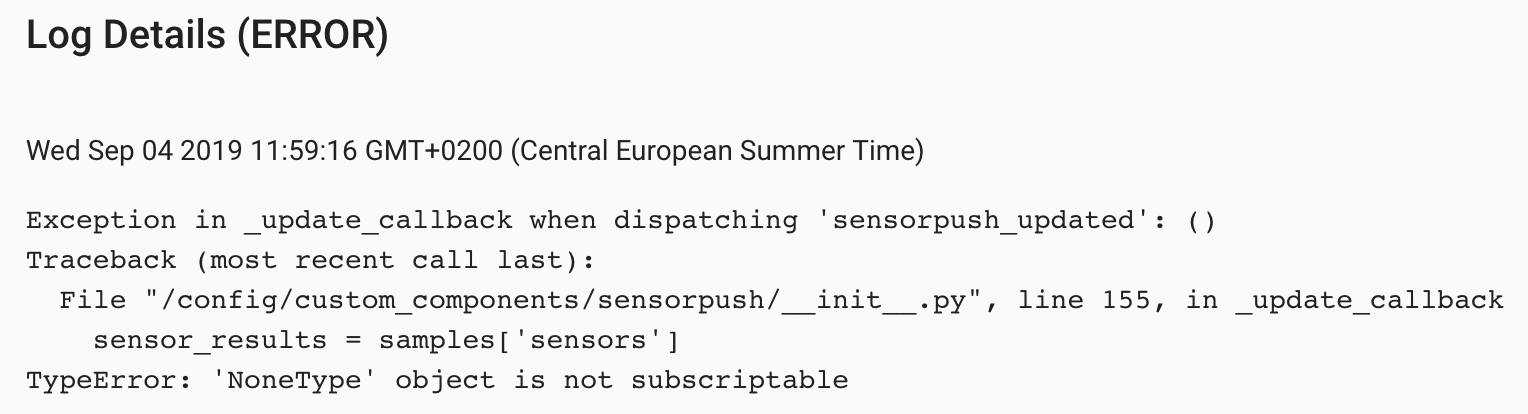

FYI, the NoneType object (sensor_results) is fixed in the latest version as of 8 days ago. I didn’t post that to this thread.
