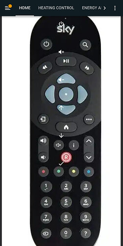

With the new Sky integration I thought try make a remote for it. Early stages, just got a few basic buttons on the card (and they’re not aligned). Button actions are from a script.
Is there any way to just have the buttons perform the action without the pop up then having to hit run?

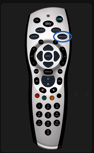

Just starting but this bit of code seems to work for me.
type: picture-elements
elements:
  - type: action-button
    style:
      left: 64.5%
      top: 10.5%
    action: remote.send_command
    title: "On"
      entity_id:
        - remote.192_168_0_61
      command:
        - power
image: /local/skyremote.png
If you leave the title text blank it still creates a hotspot on the location that works when pressed. So no text overlay on the buttons and just use the remote graphic
That’s fantastic thank you! Now I have the correct command I’ve used Copilot AI to create the code for every button/command listed on the HA documentation for it! Saved me ages. I just need to reposition them all!
