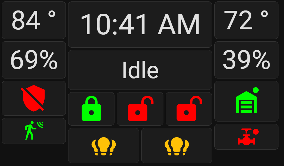

I originally got the 7" tablet for information and not control. The wife wanted to know the status of specific items at a glance. It is on the shelf under our TV.
Left column is:
Outside temp
Outside humidity
Alarm (green = armed/red = disarmed)
Notify on motion boolean. Turn on/off camera notifications to our phones. If I am doing stuff outside, she does not need the notifications every time I pass a camera.
Center column is:
Time
HVAC status
Door locks (front, back, basement)
Basement lights (main basement and office)
Right column is:
Inside temp
Inside humidity
Garage door open/closed
Irrigation running or not
Once I put these in the office and garage, I did add tap actions to many of those items to toggle them.
Above this, I have several cards that are hidden until something happens.
If the doorbell cam triggers, show the live feed.
If the driveway cam triggers, show the live feed.
If the deer camera triggers, show the live feed.

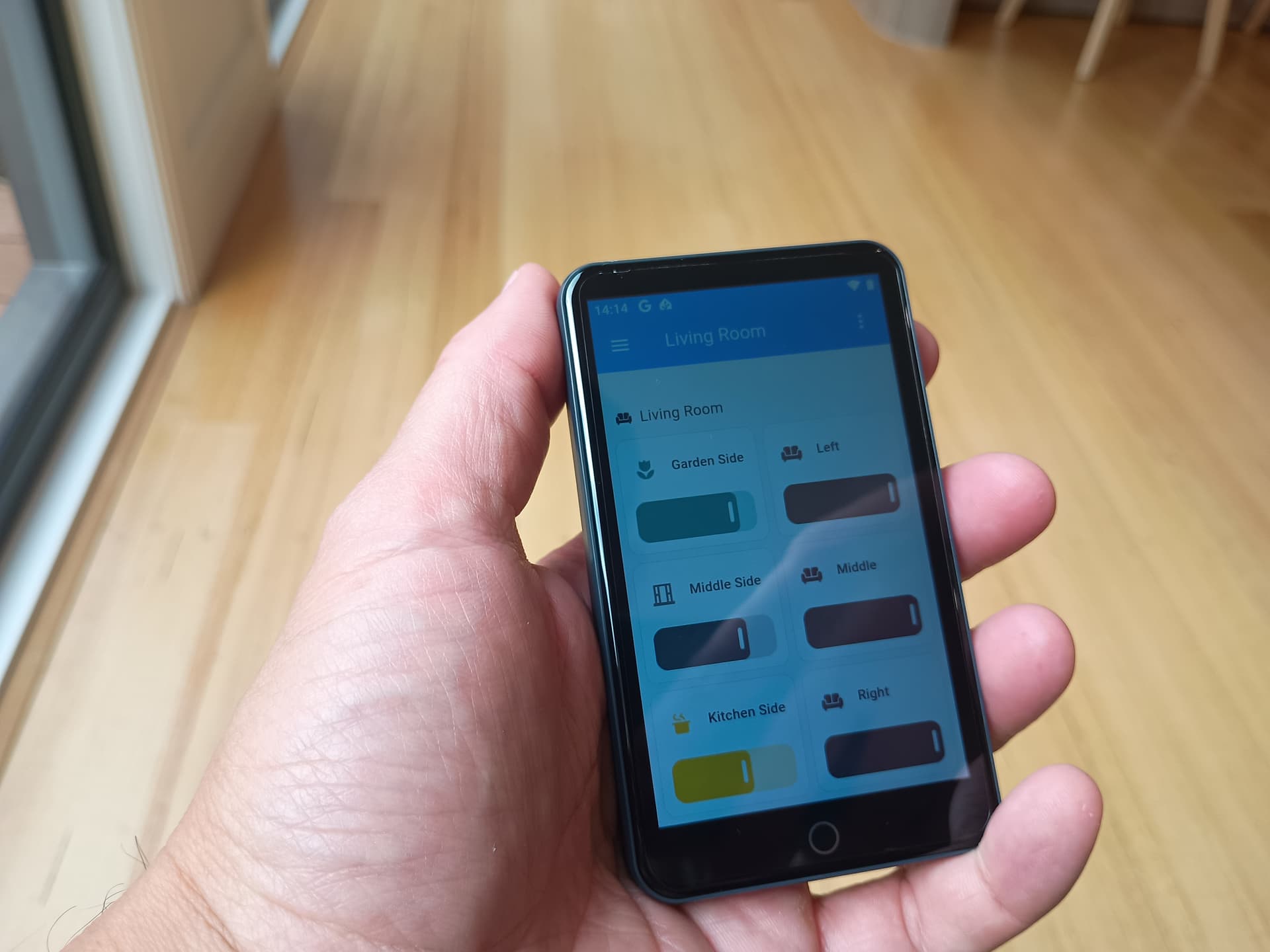

Refurb pixel phone in custom enclosure

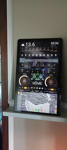

I find 15.6" to 21" vertical screen a good size, see status from across the room, go up to screen if you want to interact. We don’t use voice much, the house performs most functions automatically. Through presence, temperature or time.
