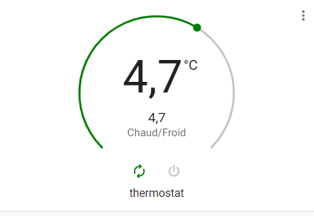

I just bought a thermostat and try to install Tuya integration, but I got the same issue. Even if there is a conversion issue on Home Assistant, the problem is coming from Tuya site.
If you look at my screenshots, the Smart life app is displaying 23.5°C then on tuya site the value is showing 47°C so it is multiplied by two. Then it is divided by ten in HA.
So before trying to convert in HA, it would be better to open a change request to Tuya teams, but I didn’t found where to do that.
That’s 4.7 not 47

47 is the value seen by tuya’s site. 4.7 is the value seen by HA
hvac_modes:
  - 'off'
  - heat_cool
min_temp: 1
max_temp: 7
target_temp_step: 0.5
friendly_name: thermostat
supported_features: 1
current_temperature: 4.5
temperature: 4.7
You should have two temperature values for the climate integration. current_temperature is the big display

@PatriceL 4.7 needs to be multiplied by 5 which is 23.5° and the beginning of this thrtead explains exactly how to fix this.
