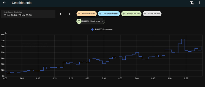

This is whats happens with my lights when using this script… The lights keep turning off.
My threshold is set to 200 and as you can see it drops more than once under that threshold and a couple of minutes later is peaks above it.
So i’ve created a manual filter sensor that monitors the average for 3 minutes, the most of the drops will be filtered out.
  entity_id: sensor.bh1750_illuminance
  filters:
    - filter: time_simple_moving_average
      window_size: "00:03"
    - filter: time_throttle
This gives me the opportunity to get my own average sensor that i can use for this blueprint.
