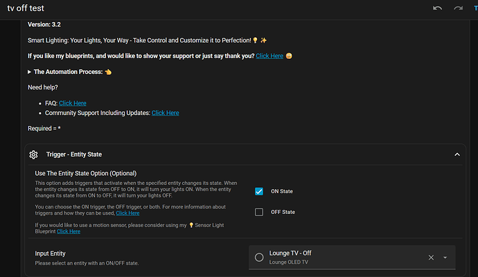

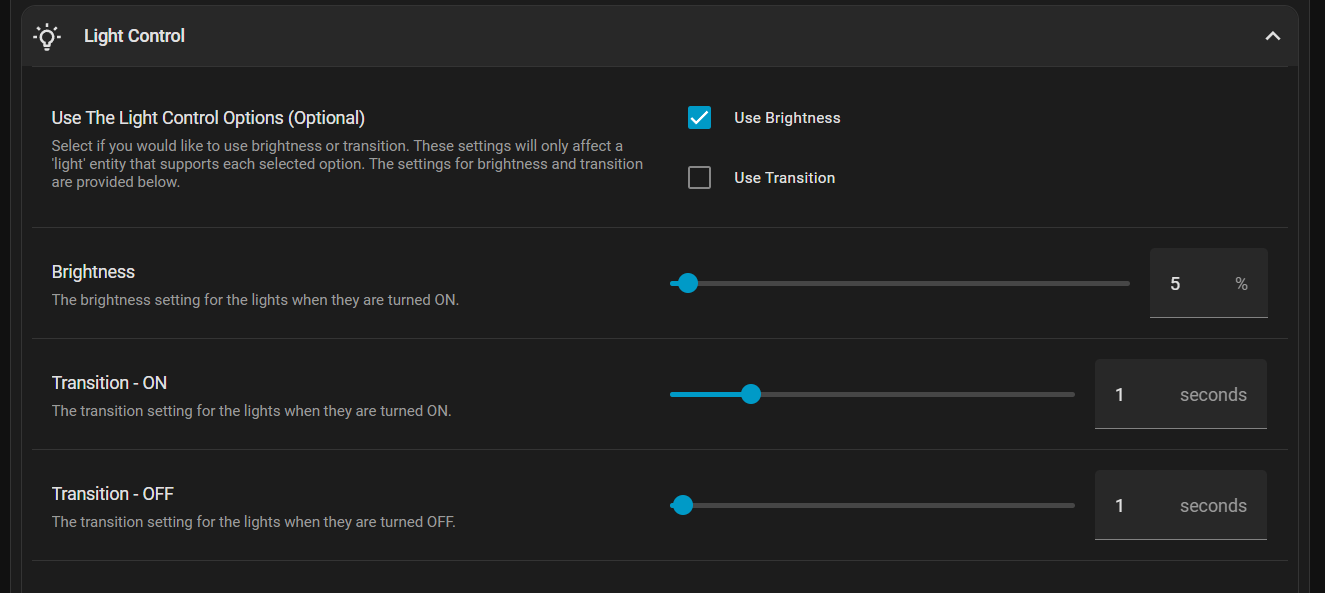

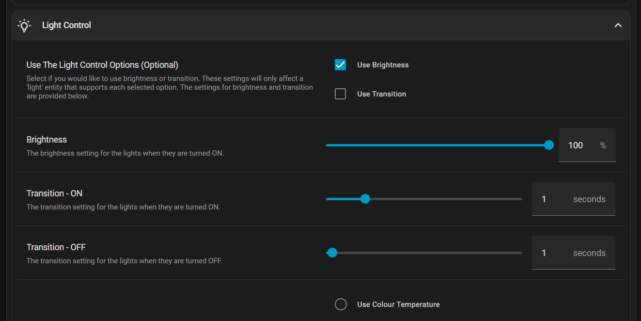

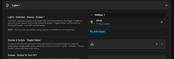

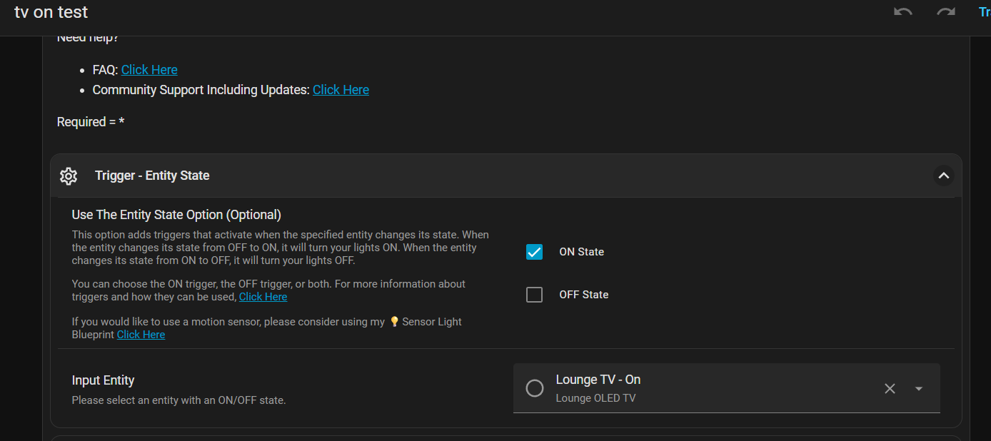

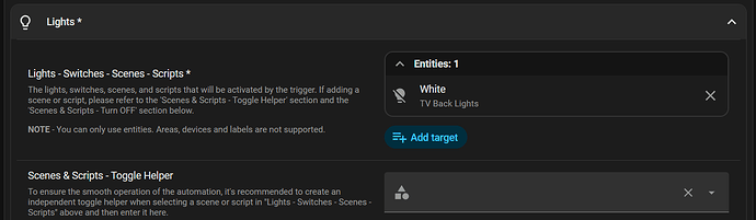

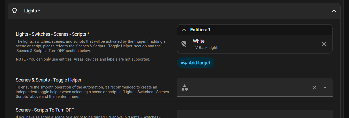

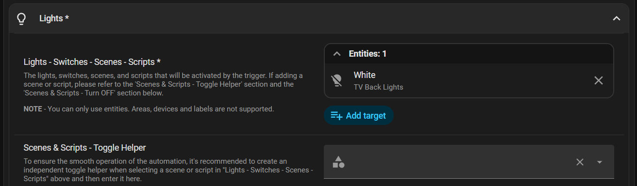

I have an LED strip at the back of the TV, I want to control the brightness of them when the TV is On / Off.
Iāve tried to setup the automation as follows, but it doesnāt seem to be working.
The TV uses the following state ID: [media_player.lounge_oled_tv]
From what I can see, it has 4 states, on, playing, off, unavailable
on - When the TV is initially turned on
playing - Changes to this state is something is being watched
off - when the TV is turned off
unavailable - Changes to this state shortly after being turned off
