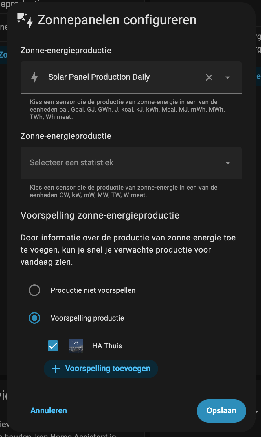

Does anyone know what to fill in for the second entity?

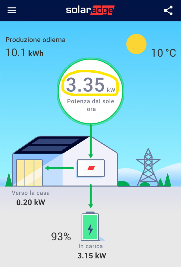

Hi @WillCodeForCats,
I’ve installed your Integration and enabled ModBus on my SE6000HD inverter but the data I receive in Home Assistant are not compliance with the same on Solaredge App.
For example the Solar Power I expect to be in sensor.solaredge_i1_ac_power have a value that seems to be wrong in decimal position or wrong unit of measurement.
This is the log, there is some Meter problem?
Where is the problem?
Thank you.
Luke
You are seeing 3.35 (solar) - 3.15 (battery) = 0.2 (ac power) from the inverter.
You will need to use templates with a battery. The integration only provides the data that modbus provides, it doesn’t do any internal calculations or change the modbus values.
