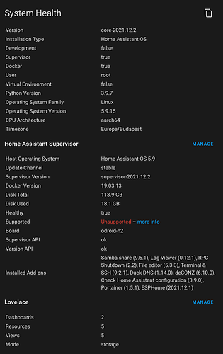

I’m in the same situation. I’ve been using a Home Assistant Blue from Hardkernel for a long time, and I didn’t have any problem with the setup. Today I updated to the latest Home Assistant version, 2021.12.2. The setup works fine, and everything is up to date except Home Assistant OS, which is stuck on version 5.9.
Besides, I have no idea why it suggests I am running an unsupported version of HA when I am clearly up to date to 2021.12.2?

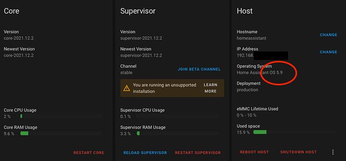

Configuration highlights an update, and I click on the blue update button:
Screenshot 2021-12-16 at 20.08.06
The system is working for a couple of minutes, reboots the host, everything loads, and says I am still on 5.9. I see the same warning in the log as it was mentioned before:
21-12-16 19:50:55 WARNING (MainThread) [supervisor.resolution.evaluations.base] OS-Agent is not correctly working (more-info: https://www.home-assistant.io/more-info/unsupported/os_agent)
System status:
Does anyone have any idea? Thanks!
