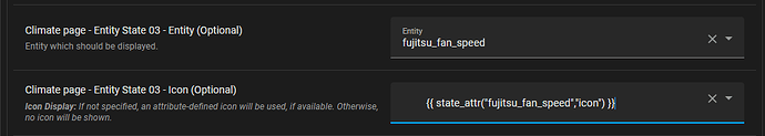

It’s also possible to have an icon based on the state that changes depending on the fan_mode.
clideo_editor_383410e2125c43979e4cbe7fd87382ad_2 (online-video-cutter.com)
To make this work one change in the blueprint is needed.
Blueprint:
{{ state_attr("fujitsu_fan_speed","icon") }}
You can have either just the text
or
just the icon based on the state
or
text+the icon based on the state like in the short video
