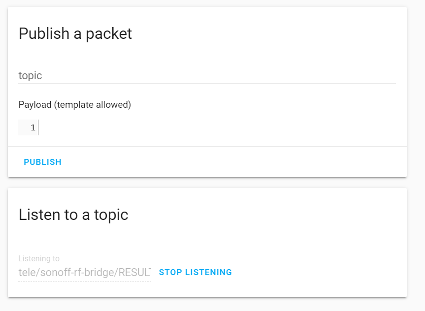

I’ve got the sensors paired and have added the config to my binarysensors.yaml file but it doesn’t seem to be working and I’m not sure where I’m going wrong, I’ve watched a bunch of YouTube videos, read tons of forum posts, chopped and changed the config but am unable to get it to work so hopefully someone smart out there can help me get on the right track.

A copy and paste of my Entity ID under Device Info
binary_sensor.sonoff_rf_bridge_button1
