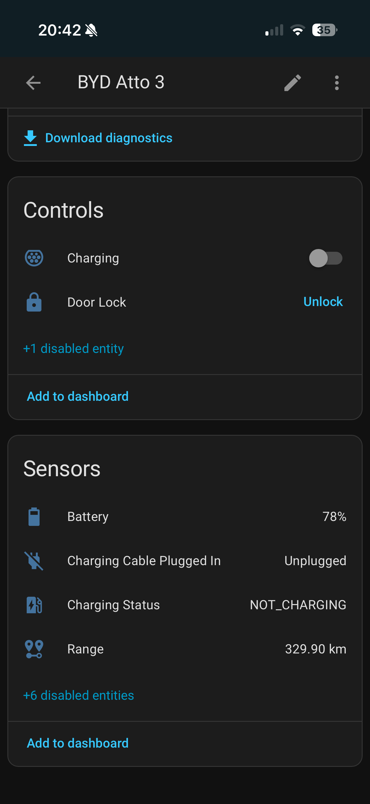

Source for BYD Atto 3 battery state of charge
Possible you can give us a guide?
Sure, I’ll leave you a link to download the MIK app.
MIK APP
You must have ADB running.
It’s a dashboard that can replace BYD’s Dlink, so I don’t recommend it.
It allows for a lot of customization for the car, but in my case, I only use it for MQTT.
You have to configure the app to start with the system.
The app is all in Chinese; you can use Google Lens to help.
Sorry, I don’t have any screenshots to upload right now. Go to the last configuration option and find the MQTT section. In my case, I started the tests by pointing the Home Assistant IP to the Mosquitto addon in HA locally. Once it was working, I opened a port on my router and sent it over the internet.
The app communicates when I turn the car on and off; during the trip, it doesn’t send information.
In HA, I created the sensors manually, using AI. The sensor template may vary depending on the car, but they review it with MQTT Explorer and adapt it.
Tips:
I have automations with a summary of each trip, a service notification when the mileage is reached, and a notification to charge it when the battery is at 25% or less, etc.
I’ll upload some images of the MIK app later.

I have finally managed to get my Atto 3 into HA today via smart car integration
Do you have a link to the integration you used?
Created an integration on smartcar.com (used free tier) created a second “authorised account” via BYD app as per smartcar instructions.
In HACS added smartcar and linked it.
I’m going to say if I can do it anyone can do it!
The free version on smartcar has some limits but I’ve achieved what I have been trying a year to achieve
But they’ve recently opened the free tier up to include webhooks which is a huge plus!

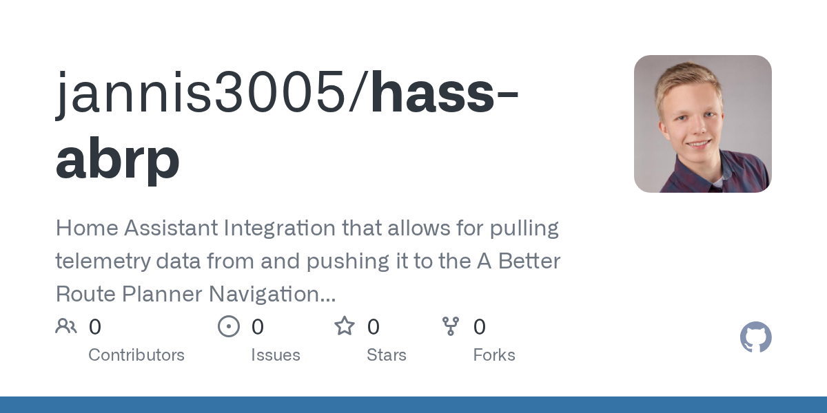

Looks like someone has created an integration for A Better Route Planner. It’s still early, but seems cool.
