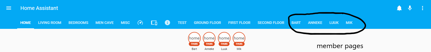

It would be awesome to have different spotify-cards on each family member page, showing the playlists of that member’s account. And when you click on a playlist in that card, it plays with the corresponding spotify account. That way each family member has his/her own spotify page in HA. Something like that :smiley:

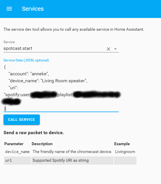

When I do a service call like this, it does play but it still uses my spotify account instead of Anneke’s:
I’m happy to further do tests whatever you want.
Regarding the spotify-card I meant this:
Hope I made things a little more clear, if it’s too much work don’t bother.

@QkulleQ I see, I still don’t understand if it is on the same device the tabs are to be clicked or on different devices. If you want the users to use the same browser on the same device I think it will be difficult because of shared cookies et.c.
edited: found the bug. pushed the change, can you test?
Sorry @fondberg, it’s still playing from my account only.
I reinstalled the component and tried 2 different accounts, but they are both playing with my spotify account after the service call.

About the ‘member tabs with spotify-cards’, I wouldn’t mind if the tab is only working when the member is logged on his/her own device or windows account.
Of course it would be preferable if it would work regardless of the device or account, but if that’s technically not possible no big deal.
