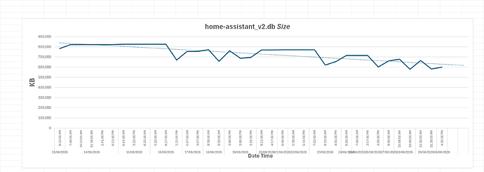

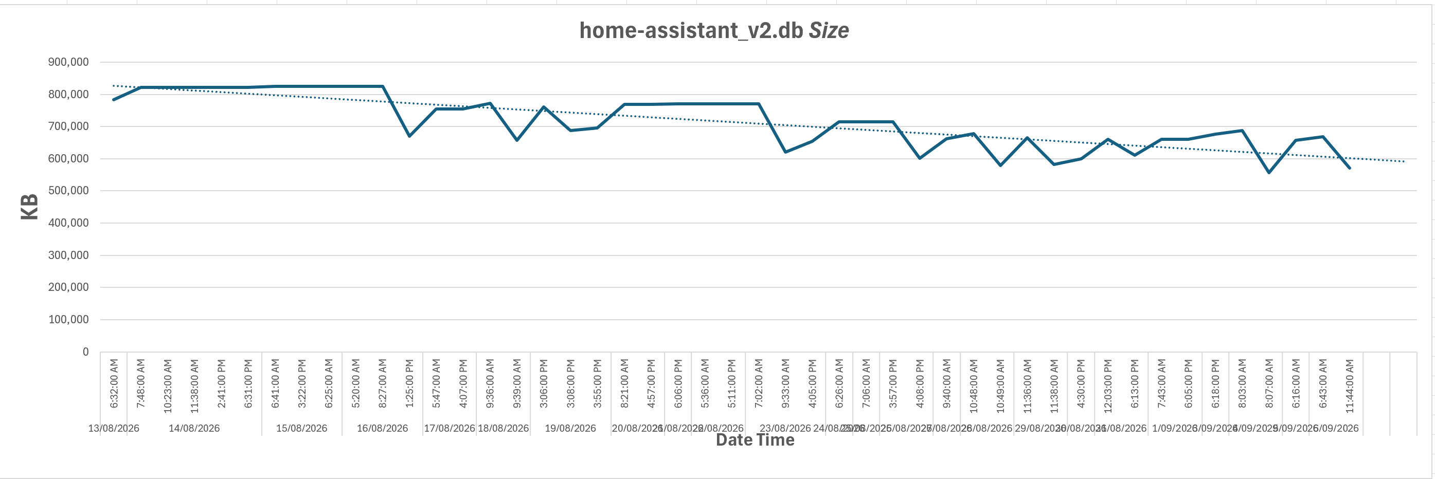

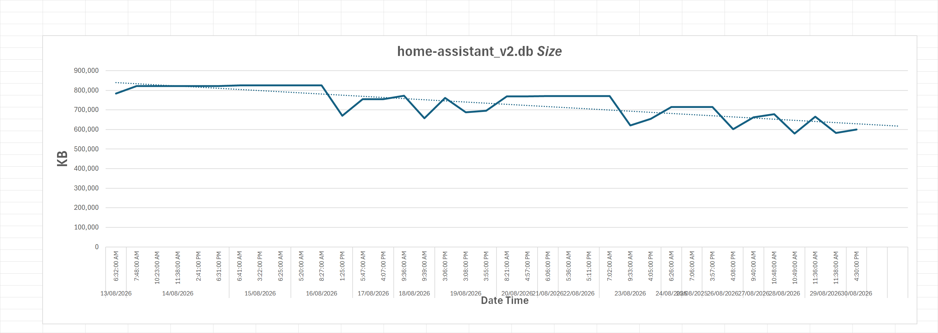

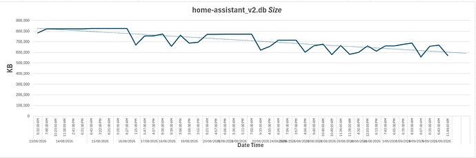

This morning I loaded the latest update 2026.9.1 and latest Spook. I fixed spook repairs.
Did a purge and repack.
This is DB size graph
Have you installed the latest two September core updates? Not hit the delete everything button that had unintended consequences people didnโ€™t anticipate? Grafana still there?
Youโ€™ve cleaned up pretty much everything in the current recorder database that could be purged, and the long term statistics arenโ€™t there for any length of time as you started with a new database only recently. There are other issues that are currently being looked at.

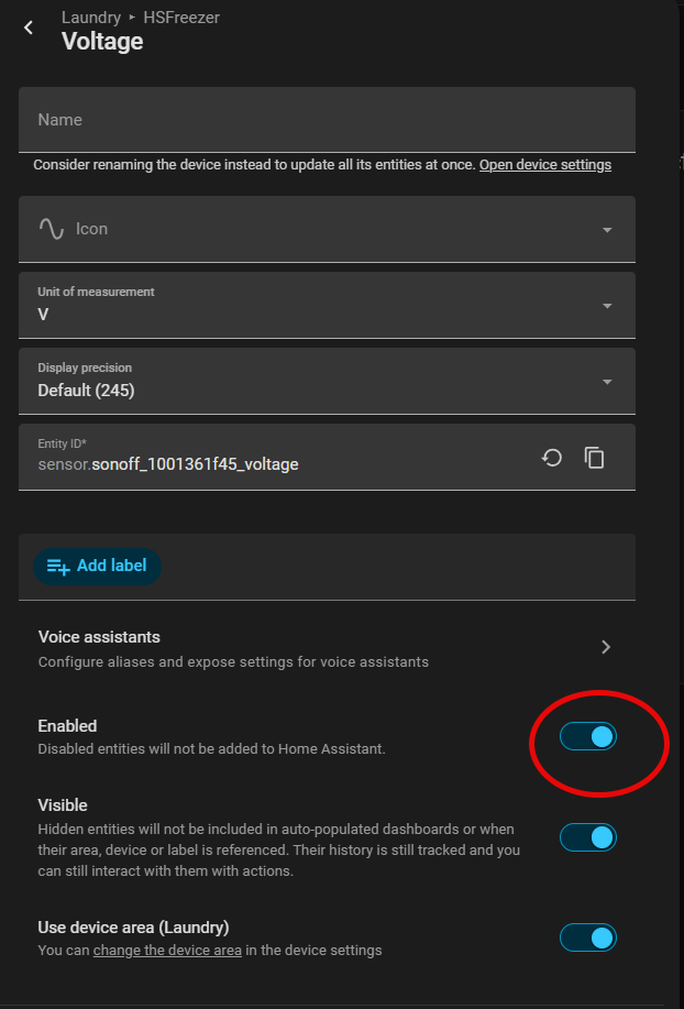

Iโ€™m looking at your sensors you are storing data for.
โ”‚ sensor.sonoff_10012393db_voltage                    โ”‚ 76017 โ”‚
โ”‚ sensor.sonoff_1001361b68_voltage                    โ”‚ 74817 โ”‚
โ”‚ sensor.sonoff_1001361f45_voltage                    โ”‚ 73610 โ”‚
โ”‚ sensor.sonoff_100123ae52_voltage                    โ”‚ 72001 โ”‚
โ”‚ sensor.sonoff_1000cd7a20_voltage                    โ”‚ 71688 โ”‚
โ”‚ sensor.sonoff_10012393d2_voltage                    โ”‚ 68508 โ”‚
โ”‚ sensor.shellyem_34945470fae8_channel_1_voltage      โ”‚ 56303 โ”‚
โ”‚ sensor.shellyem_34945470fae8_channel_2_voltage      โ”‚ 56303 โ”‚
Pull up graphs of these over an hour, day, week, year and see by how much they vary.
Does your voltage vary at each sensor point on each sonoff? By much? The same amount always? Are they in sync, following each other up and down? Once you confirm it is close to normal 230/240/250v (depending on your location in respect of the power station and street wiring which you have little control over, and local load, which you do), is it important to keep those statistics longer term? Unless you are having issues you need to discuss with your power company, maybe these donโ€™t need to be stored, just monitored for normality, and a possible trigger alerts if they fall outside the nominal Australian standard +/-5% range, maybe triggering above 265 volts (surge) and below 210 (brown-out)? Yes you have to collect voltage to calculate wattage/power from multiplying current and voltage, but do you need to store it longer term?
Maybe store the ones from the Shelly EM (which should closely match all the other ones). Yes, keep the power consumed, measure in current (amps), wattage (volts x amps), consumption, energy, but you could probably cull those voltage sensors from being stored long term, and prune even more from your database.

You are correct in assuming that I donโ€™t need to store Voltage as a Long Term Statistic (LTS) but I donโ€™t know how to stop that for the Sonoff devices and not the Shellyem? The Shellyem is what monitor my switchboard and the Sonoff devices are used for individual power consumption.
So can you enlighten me on how to do that please?
OK I just had a thoughtโ€ฆ
If I disabled the voltage here for sensors I donโ€™t want voltage, would that work?
ORโ€ฆ
AI suggested add this to the customize.yalm
homeassistant:
  customize:
    sensor.your_device_voltage:
      state_class: none
I have no โ€œadd onโ€™sโ€ or Voice assistant things that use this as far as I know. For Voice I use either Google or Alexa at this stage as I have Google display hubs and Amazon speakers. that do my voice (apart from phone).
