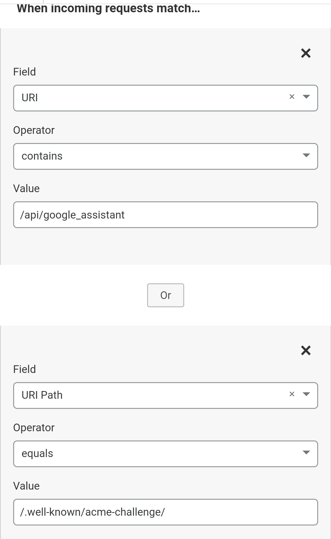

I just went with a simple approach for Cloudflare Access on HomeAssistant, set the access policy you just to:
https://[YOUR HOME ASSISTANT URL]/auth/authorize
All requests made your instance will be redirected to this URL unless they are authenticated or they’re calling an API or some other resource, for example Google Assistant API is located under:
https://[YOUR HOME ASSISTANT URL]/api/google_assistant
For LetsEncrypt is:
https://[YOUR HOME ASSISTANT URL]/.well-known/acme-challenge
Based on the rule as I have it, it will work for these two.

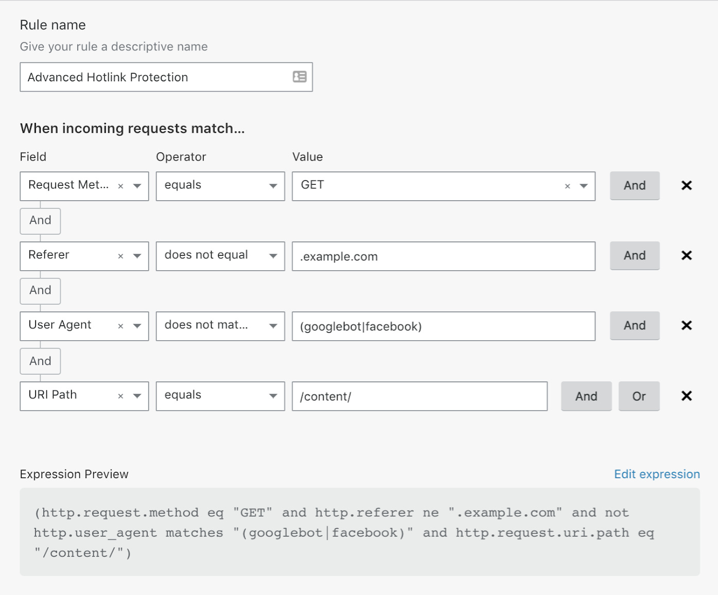

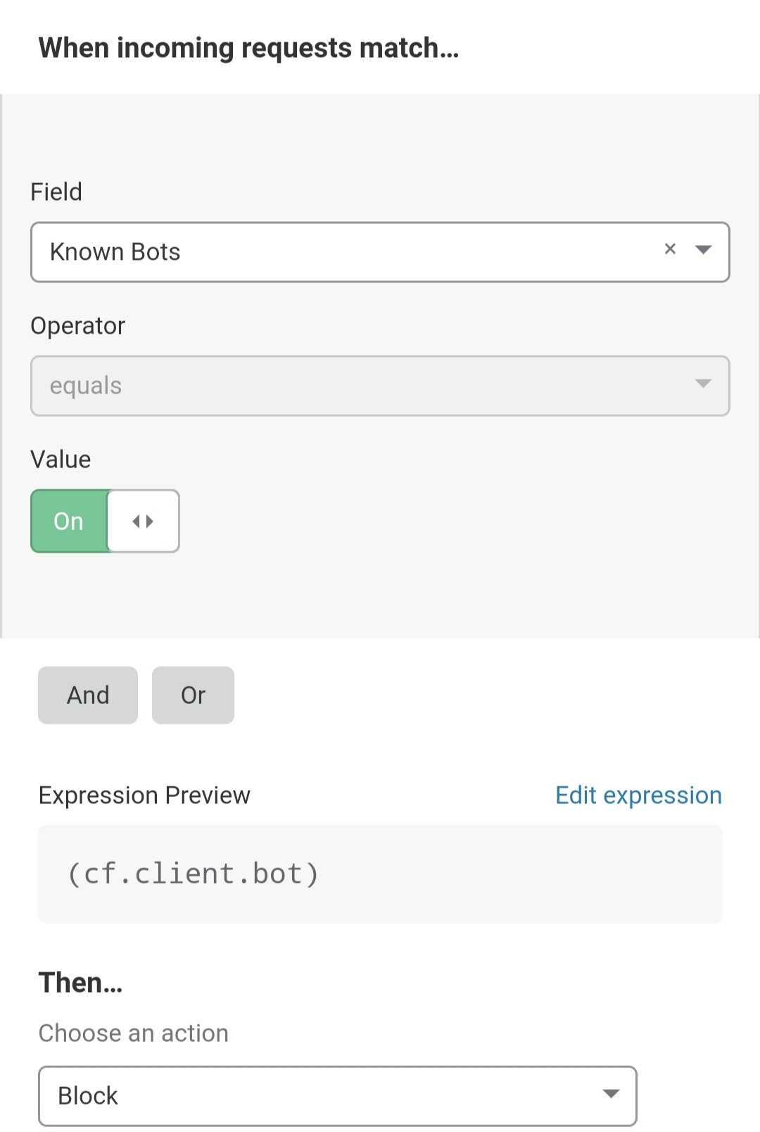

I advice you to use Firewall rules and block bots by default, challenge (or captcha) low to medium risk IP (10-20) and block high risk (30). This will get rid of all nasty bots and anything from know malicious IPs, nearly all the bad traffic is bots (about 150-200 request made by bots are blocked daily by this rule).
The bright side of all of this is that to get through they’ll need to pass through Cloudflare and even if someone had your IP your NGINX will reject connections unless it matches a proxy entry. I’m no security expert but I guess this alongside HTTPS full encryption, DNSSEC and so on make for a good deterrent. Since I’m no pentester or security expert I’d like to hear from someone who knows better, but as an IT consultant it seems sufficient.
According to Cloudflare example you can whitelist bots as per below but I haven’t tried it:
Here’s all about the Firewall rules, it looks complicated but it’s all GUI based and very simple… The only thing is learning the variables you can use and the possible values which you can find here:
There’s a parameter to whitelist “good bots” or if you’re like me I block all bots (default if you enable it) and exclude the ones I use like Google Assistant, Uptime Robot, etc.
For LetsEncrypt and Google Assistant this works for me:
It’s very important to know that if your LetsEncrypt certificate isn’t working anymore when using Cloudflare it is very likely due to Cloudflare Access or the Cloudflare Firewall.
You can always bypass all of this by turning off the proxy feature for that DNS entry like below (grabbed the image from the Google, not my domain):
It is the orange :cloud: (Cloud) icon with arrows. You can use this as a quick fix to tell if something in Cloudflare is the issue or if it’s somewhere else. For some services you’ll need the proxy feature disabled like most classic VPN protocols.
