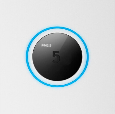

Can’t tweak the color change based on the value in picture-elements. In type: entities, everything works. help me please
elements:
  - entity: sensor.purifier_air_quality
    style:
      card_mod:
      color: >
            {% if states(config.entity) | int <= 2 %}
              green
            {% elif states(config.entity) | int <= 4 %}
              greenyellow
            {% elif states(config.entity) | int <= 7 %}
              yellow
            {% elif states(config.entity) | int <= 9 %}
              orange
            {% elif states(config.entity) | int <= 12 %}
              red
            {% endif %}
      font-family: Trebuchet MS
      font-size: 500%
      font-weight: bold
      left: 45%
      opacity: 1
      pointer-events: none
      text-shadow: 1px 1px black
      top: 50%
      transform: translate(-20%,-50%)
    type: state-label
image: /local/ac3829_10.png
type: picture-elements
Start with a correct syntax:
card_mod:
  style:
Thank you! Stupid error! But it didn’t help. Now the value is not displayed at all
I’m a beginner, apparently I’m doing something wrong
You are mixing 2 different styles:
Now your stock picture-elements styling stopped working since you moved it inside card_mod section.
