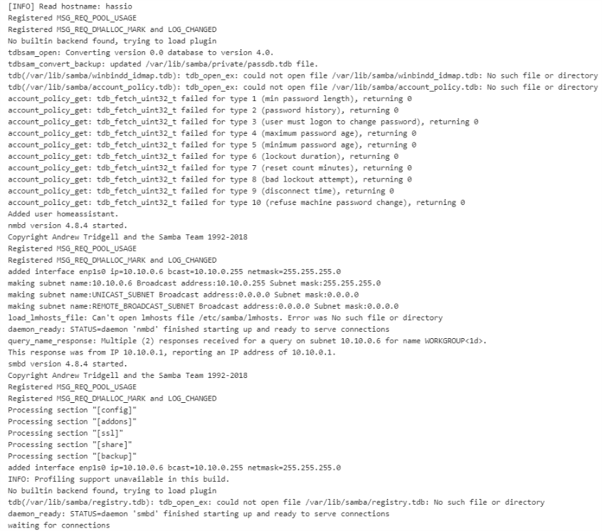

thanks, i can see the SMB share through network discovery in windows, sadly im getting the following error:
Smb_addon config:
“workgroup”: “WORKGROUP”,
“username”: “homeassistant”,
“password”: “homeassistant”,
“interface”: “enp1s0”,
“allow_hosts”: [
“10.0.0.0/24”
SMB log:
SMB1.0 is enabled
Update 1: 1 updated the hostname in the hassio system settings, but no luck…
Update 2: reinstalled the addon, but still not working…
