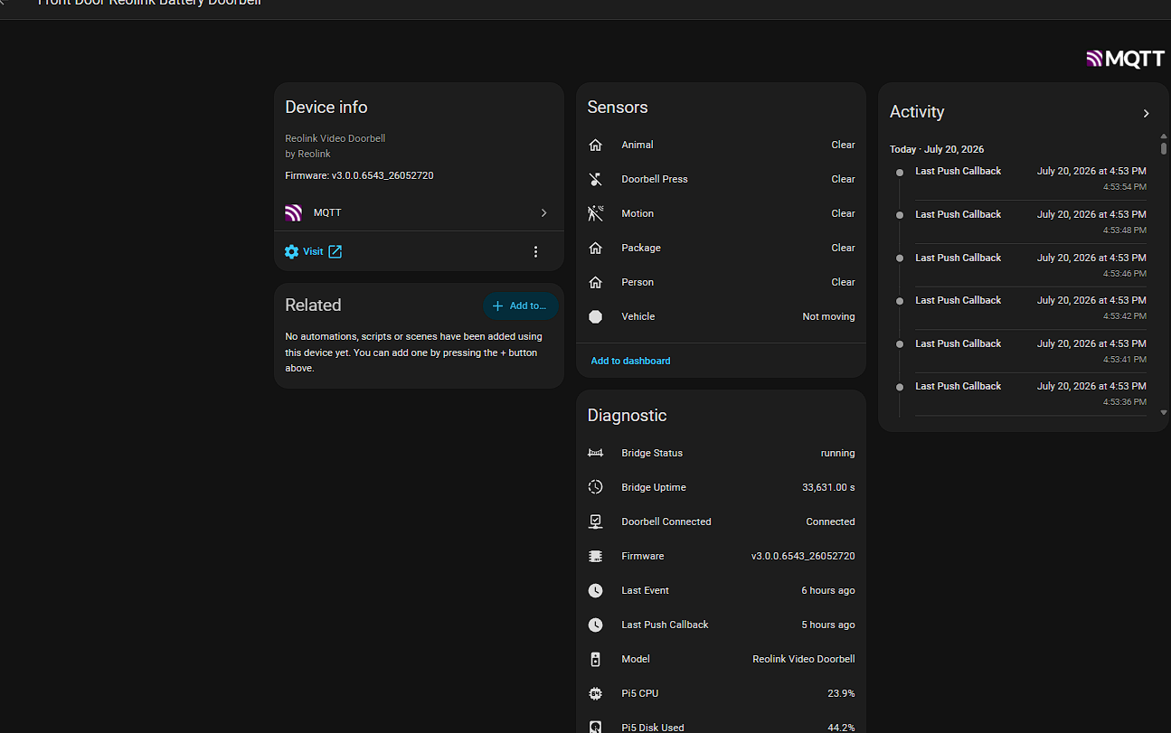

WORKAROUND! 1st solution below killls the battery, seconnd solution (7/23 update - WITH SOURCE CODE BELOW!) works perfectly woithout affecting the battery (only detect motion, not what type):

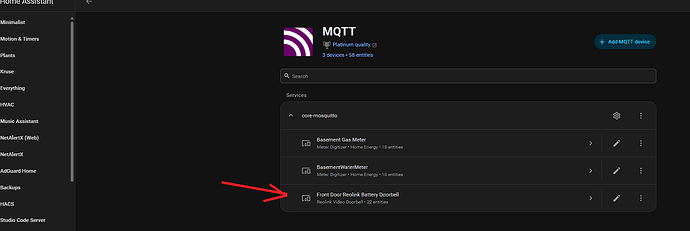

When I discovered this issue, I built a standalone Python service using reolink_aio that maintains the cmd31 subscription and publishes the local AI events (person, vehicle, animal, package, motion) to Home Assistant over MQTT. It works well functionally and gives very low-latency local events. During testing, though, I did notice battery dropping faster than I would have liked which did go away when I replaced my ancient transformer with a 16V 30VA one.
So although I am actually good to go now with all the functionality I need, as a developer I agree 1,000% with your your explanation that a continuous cmd31 subscription keeping the battery camera awake makes a lot of sense and matches what I was seeing. Assuming the new firmware provides the same local events through the webhook mechanism while allowing the camera to sleep normally (and I hope they are as fast or nearely as fast!), I’d much rather use that than maintain a continuous cmd31 connection and will switch over as soon as I can to hopefully retire my custom code. I am already using code like this to rely upon for automations that just need to be triggered as quickly as possible when there is ANY motion detected) so I can just throw the switch to cut over (those with _battery_ in the ID are the custom engineered MQTT fed versions)

So as you can imagine there are alot of us chomping at the bit for this! You did say “2-3 months”… yikes. You cetainly have done all of your due diligence quickly. Is there any way we (you?) can get a more definitive timeline from them (do they have an SLA or estimation they can give you for firmware releases or a QA/UAT schedule they have in mind)?
Update 7/23/26: I wanted to provide an update after spending the past week experimenting with my white Reolink Battery Doorbell (D340B).
Since the battery doorbell still doesn’t expose the same local push events as the powered models, I started investigating whether there was another reliable way to detect events locally.
What I found is that the doorbell briefly opens a TLS connection to pushx.reolink.com whenever it is online for the non-video traffic. By passively monitoring outbound network traffic (using tcpdump on a Raspberry Pi as shown below), it is possible to correlate bursts of traffic on that connection with the doorbell events. And it really works well! Unfortunately it is not as immediate as the above which keeps the doorbell awake so the latency of the doorbell waking up is stil unavoidable but it works perfectly. I ended up writing a passive observer that:
  • The above chews the battery up snd spits it out, not really maintainable (as everybody would probably say!)
  • The below uses ZERO BATTERY on the battery doorbell - does not even connect to it!
  • Does not connect to or poll the doorbell
  • Does not intercept or modify any traffic
  • Simply watches for activity on the existing encrypted connection

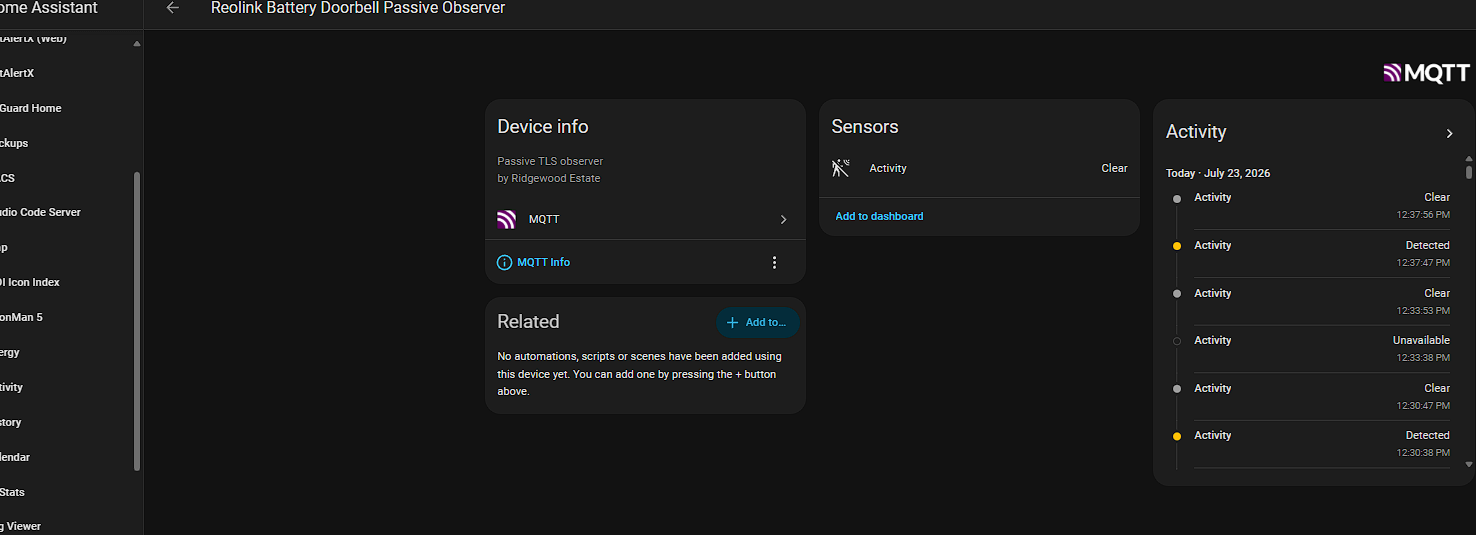

  • Publishes a Home Assistant MQTT binary sensor that turns ON when an event is detected and OFF after a configurable timeout
  • After several days of testing it has been very reliable at detecting that an event occurred (motion, AI detection, button press, etc.). As the traffic is encrypted (which cannot be decoded unless you build a pass-through proxy that stands between the doorbell and it’s network connection) - it cannot tell the difference between vehicle, person, animal etc. but DOES capture movement and it good enough for my use case anyway (to turn on the lights near the doorbell at night). It DOES knows whenever the doorbell generates an event. For my use case, that has been enough to trigger Home Assistant automations with very low latency while remaining completely passive.
This obviously isn’t a replacement for native battery-device support, but it has turned out to be a surprisingly effective interim solution.

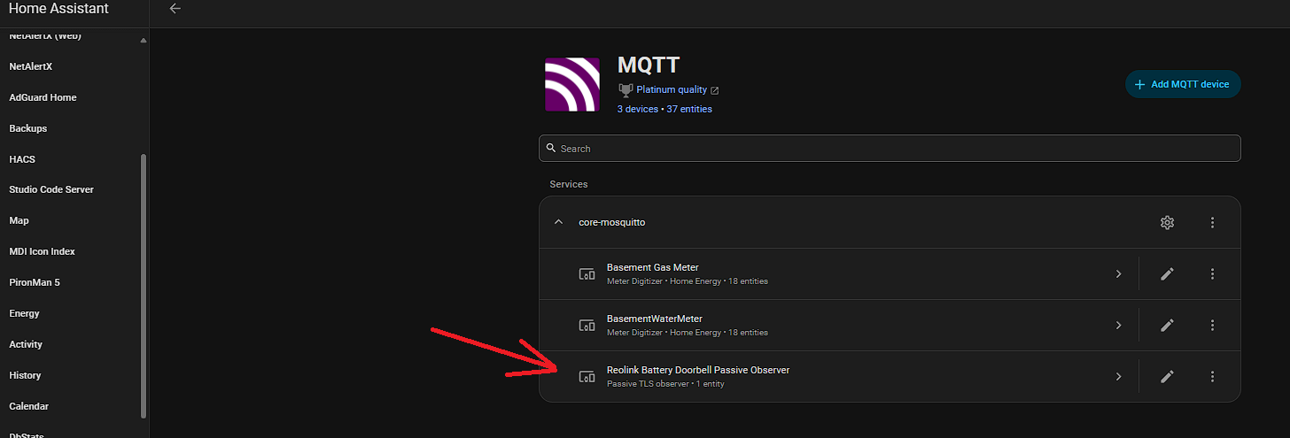

To set this up to observe the traffic from the doorbell, I have mirrored an upstream switch port that it ultimately connects to, meaning:
I have:
Doorbell → Access Point (there are many other devices connected to this acces point, but the doorbell is locked to connectting to this access point for this purpose) → Switch (port 9)
RPI5 running Rasbpian with a QEMU/KVM VM that is running HAOS → Same switch (port 3)
I have set my network up to then also mirror all the traffic on port 9 to port 3 (Omada - it is able to mirror one port to another without turning off the destination port’s other traffic - some network equipment forces you to use the destination port only for the mirrored traffic. If your network does that, you can just get an ethernet to UBS adaper and plug the additional network cable into your RPI that way.)
On the RPI5 (not the HAOS appdaemon in the VM - I tried that already - as that container does not have the right context) - I have a daemon that is running this python on the RPI5 host outside the HAOS VM - which publishes the MQTT to HAOS on the VM as mentioned above. Here is the source code - one file, very lightweight (and screen shote below that)!

The above expects a confg.json of course (I had the following settings which was working for both active broidge solution above as well as the passive observer which was my final solution):
  "capture_interface": "eth0",
  "doorbell_ip": "<static IP addres of the doorbell>",
  "trigger_hostname": "pushx.reolink.com",
  "mqtt_host": "<IP adrress of the HAOS>",
  "mqtt_port": 1883,
  "mqtt_username": "mqtt-reolink-battery-doorbell-observer",
  "mqtt_password": "<put your doorbell password here - only needed for the active connection, not passive>",
  "mqtt_topic": "ridgewood/reolink_battery_doorbell/activity",
  "availability_topic": "ridgewood/reolink_battery_doorbell/availability",
  "home_assistant_discovery_prefix": "homeassistant",
  "device_name": "Reolink Battery Doorbell Passive Observer",
  "device_identifier": "reolink_battery_doorbell_passive_observer",
  "event_hold_seconds": 10,
  "debounce_seconds": 5
The above resulting in:
Hope that helps!
I made it public with instructions. Enjoy!
