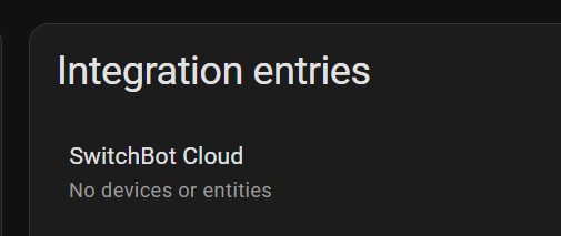

Can we get this SwitchBot Lock Pro | Electric Smart Door Lock for Home Security – SwitchBot International to work with HA at all? Ideally local api via esphome bluetooth but I have also a switchbot hub mini (matter enabled) and I have tried the cloud integration SwitchBot Cloud - Home Assistant and it does not detect anything.
Anyone got the hub mini or the lock pro to connect to HA? Not feeling great about buying two of these…
Edit:Adding the hub mini with Matter exposes nothing, so that’s another dead end

BT integration detects nothing and the same with the cloud switchbot integration and even matter, connected them to the hub mini.

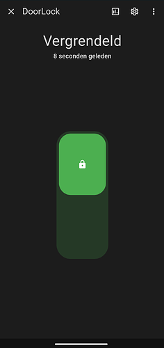

This is what i see for the door.
Nothing else is being is being transposed.
Mine is with deadbolt settings and it’s not properly working in HA. It should be like a 3rd option.
When it is blinking orange i can activate it and it will open again. The entity card allows me to lock the door again.
