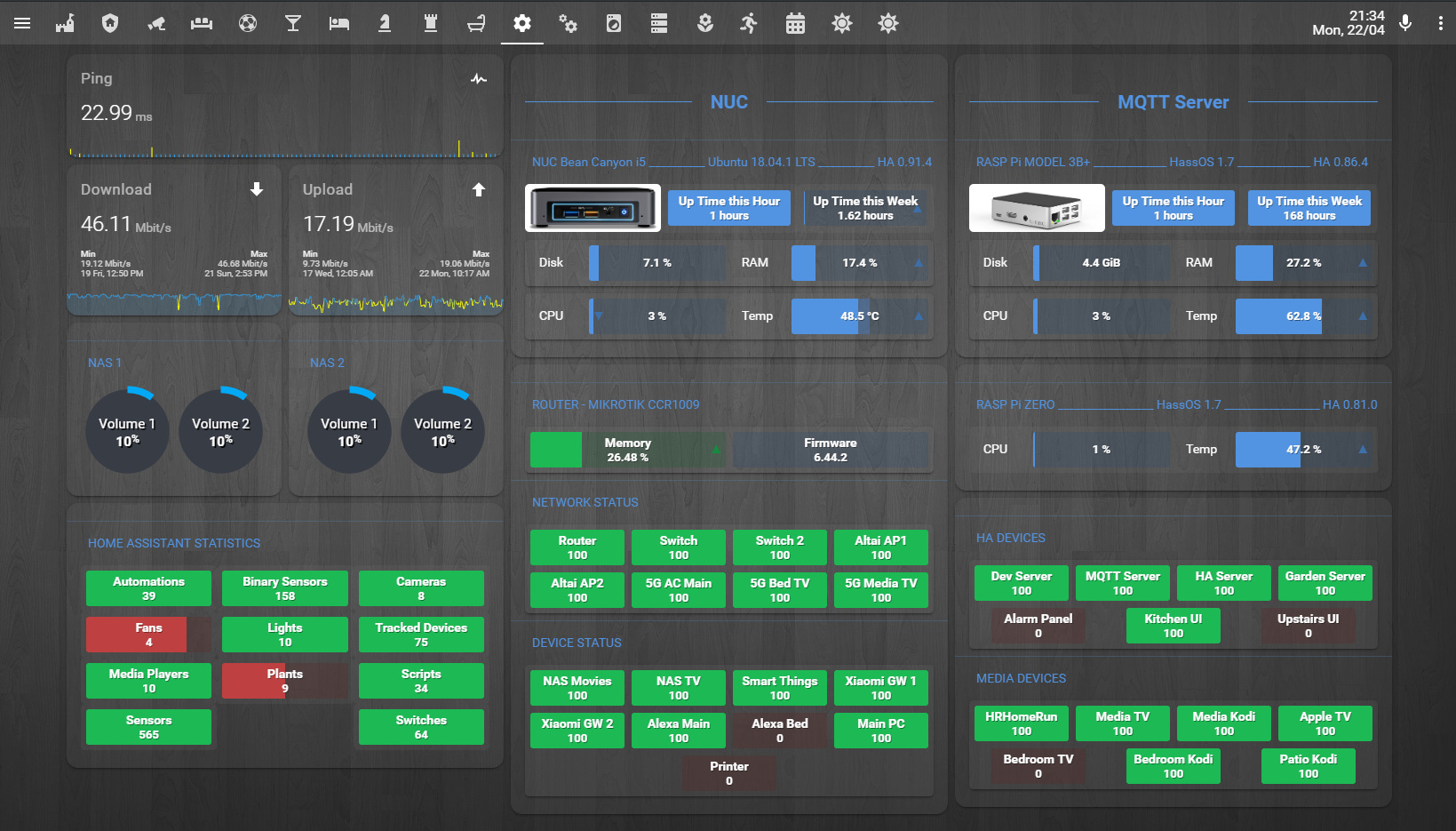

Mine is still a work in progress need to sort out some of the NAS resource monitoring and work out where I can squeeze in room for some more devices.
That looks great. I really want to apply transparency to my card backgrounds but it does not play nice with the vertical-stack-in-card.

Thanks @tom_l, really this whole page is made using the vertical-stack-in-card.
It’s the mini graph cards that stuff it up. They dont’ get the transparency applied to their background, it all gets transparent. Also the cumulative effect of two 25% transparencies mismatches with other cards.
Yeah I had Noticed that so I took the graphs out. You could use card modder to supersede the cards transparency?

Wow - that really looks nice!
Looks really nice as well.
Can you share your lovelace config?
I want to see how you have made the NUC Part where you have both the Diagrams and Bar Charts in the same Stack.
I’m interested in the NUC CPU temperature sensor.

Nice job could you tell me how you calculate mikrotik uptime? I am pulling it via snmp oid and was unsure how to convert to use able format.
Sure
