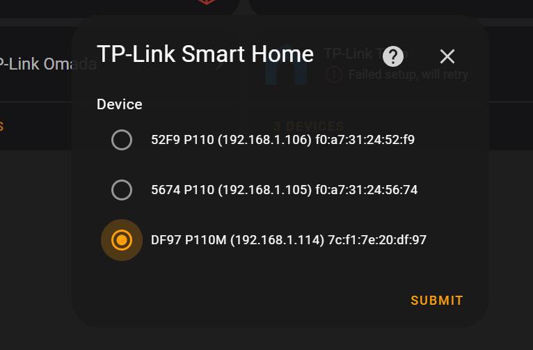

Thats exactly what I did. I basically added the device using matter (the installation automatically poped up on my android phone with bluetooth enabled) and then used the IP I got from the matter device info to add it to the Tapo integration.
No account needed, but the integration says it has connection to the cloud so I am not sure if it works fully local or not.
