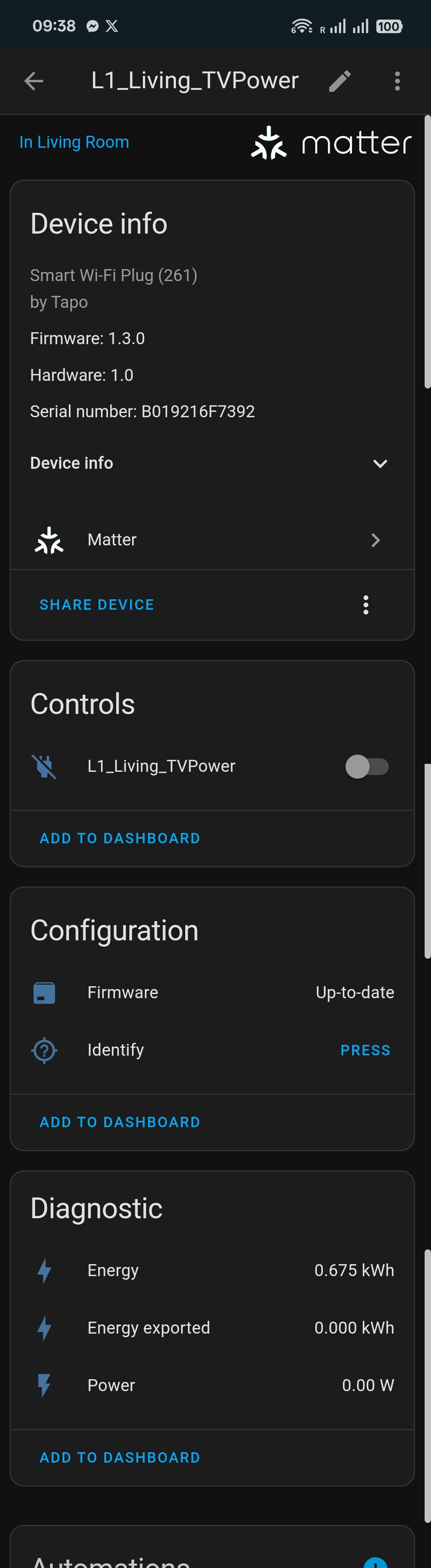

My P110M is European (I believe it came from Germany, not sure now, they have lots of regions and each one has to give the OK) and I’ve already checked for firmware updates but there’s nothing, still in 1.2.3 (Tapo version, not Matter version).
that’s a good point. I am based in Thailand, and they seem to deliver the US model to this market.
I have it connected via both Matter and the Tapo wifi.
One that is weird is that HA can see the update is available via Wifi, it tries to update but it never finishes… so I just opened the Tapo app and did it that way
Yeah, they have at least 8 product IDs for the P110M, maybe more, from 261 which is yours according to the screenshot you posted to 268. Mine belonging to EU is 262.
