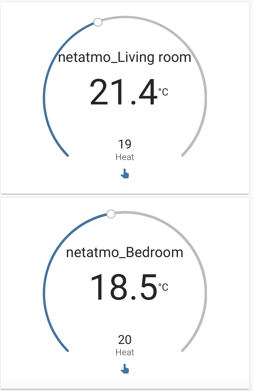

This is as expected. How the thermostat shows depends on the features which it claims to support. Of course there is neither cooling or fan support for Netatmo, only heating. It may change a bit if we adapt to the standard state names (like schedule->auto, hg->eco) in HA, but I am not sure, I need more tests.
In your situation, the hand icon is grey which means it is NOT in Manual mode, I attach mine in Manual mode (hand icon in blue).
