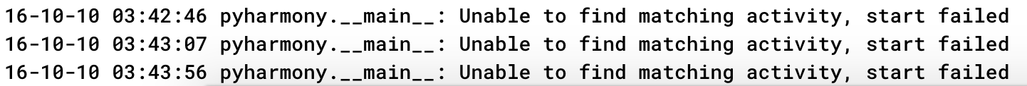

Updated and enabled the new remote component.
I’m not sure if I’m doing something wrong, or what, but after none of my activities would fire, I attempted to start an activity from the services screen and am receiving the error in the screenshot below. I’ve also attached a screenshot of the service call and my available activities from the harmonyConf.yaml.
Think your service call data needs to be
{"activity": "Watch DirecTV"}
