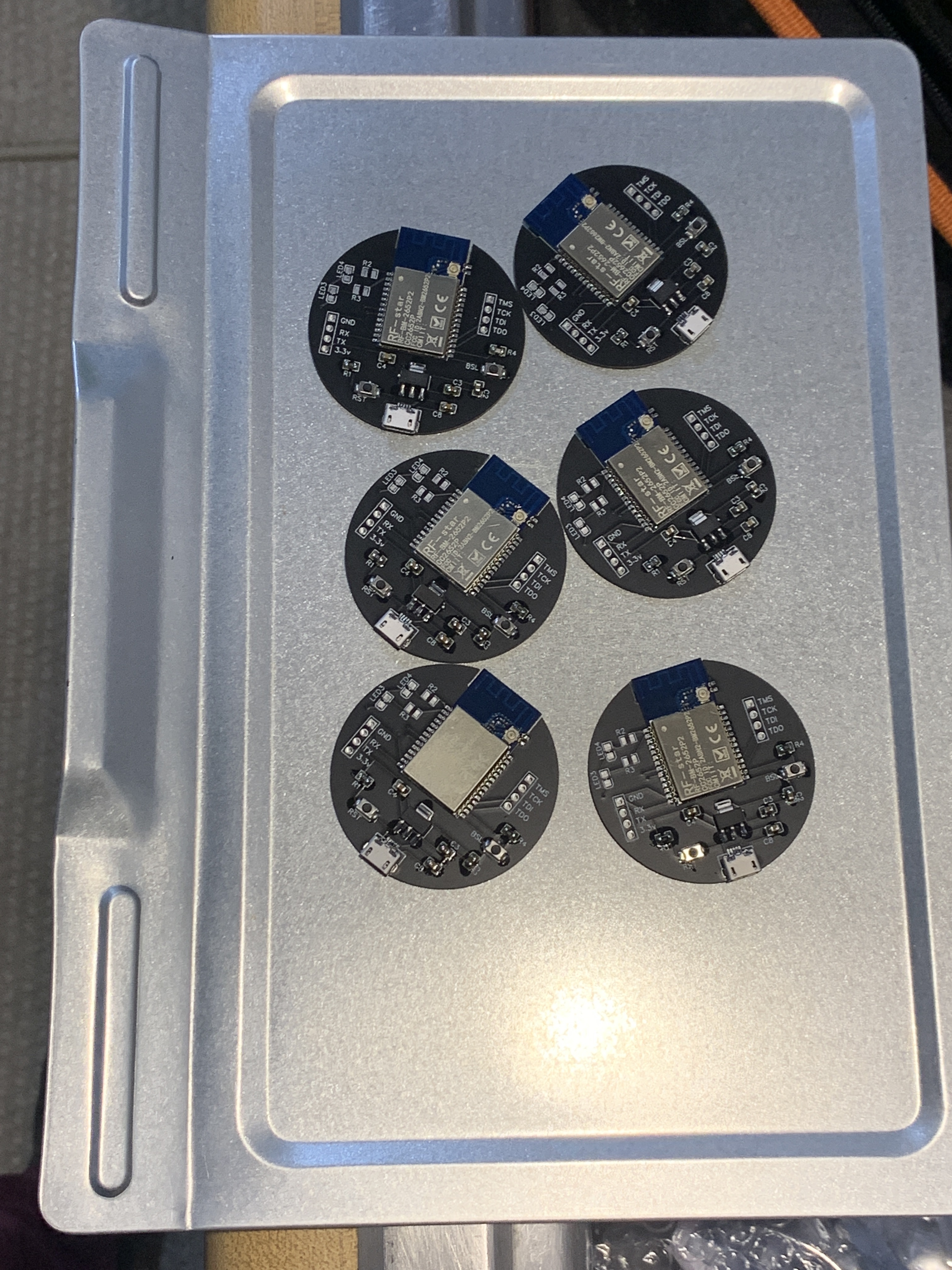

Quality Control check time… fresh from the oven.

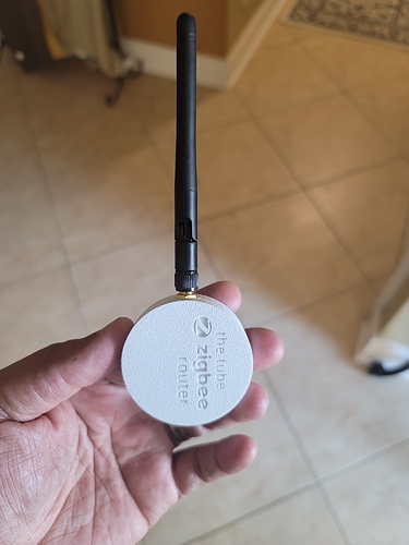

Look what I got in the mail today.
My zigbee is ready! :clap:
