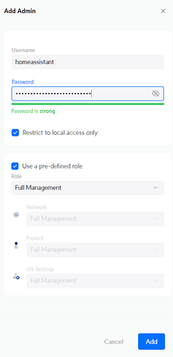

Based on the Protect documentation:
Local user
You will need a local user created in your UniFi OS Console to log in with. Ubiquiti SSO Cloud Users will not work. It is recommended you use the Administrator or a user with full read/write access to get the most out of the integration, but it is not required. The entities that are created will automatically adjust based on the permissions of the user you use has.
  • Login to your UniFi OS device. This can be done from the UniFi OS by accessing it directly by IP address (i.e. Local Portal), in the Unifi Network app or via unifi.ui.com.
  • Click on Admins & Users from the left hand side menu
  • Click on the ⊕ Add Admin in the top right corner.
  • Select Full Management for the role.
  • Check Restrict to local access only and fill out the Username and Password fields for your user.
  • Click Add in the bottom right.

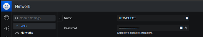

I got to this thread looking for a way to automate Unifi WiFi password changes. And, indeed, I did find the “regenerate_password” button - which seems great for my purposes!
However, I cannot find a way to actually get the new password. The QR is OK, but I need to know what password was actually set on the network (to use in other automations, and to generate my own QR code on HAss-external devices). How can one see the password that was set on the network?
Just go to the Wifi SSID in your Unifi Network and click the “eye” next to the password on the Wifi SSID you have changed …
