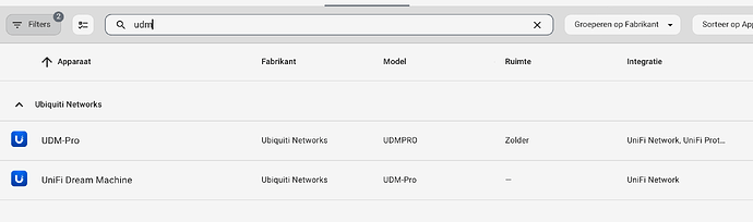

Unifi Protect showing all of my cameras as connected Ubiquiti devices, and the Udm Pro, while the Unifi Network shows all networked devices, includiung the ones by Ubiquiti, and Ubiquiti Networks.
those Ubiquiti Networks btw also list 2 UDMPro variant devices…
the top UDM-Pro is the one with all entities, the bottom one is without any entities…
lastly there’s is also this:
both without any entities. What devices are those?

wait, I now also see the 2 UDM pro entries have different Mac addresses,
ok thanks, just to be sure, they provide the same sensors of the hardware device they are running on. Which in my case is the same one and only Udm pro? In which case I can see the issue of the identical naming.
Or, is it uptime etc etc of the use of those integrations running on the devices.
in which case I wonder if it wouldn’t be nicer if the naming of the entities would be different.
