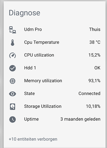

so, if I would add a secondary UNVR, that would take a lot of the heavy lifting from the UDM-pro, and also run the Protect software from that machine?
It would then also lower the memory utilization?

Yeah it’s really odd because was functioning properly before, and triggering my cooling fans.
I noticed now because the fans had been on for hours…
Really hard btw to find the temp in the UniFi app itself….
in the web interface we have /about-this-console
and there is the temp sensor:
which is a far cry from 48 C:
btw I did manually update the entity, but it doesn’t update at all
reloading the integration does update the temp sensor (the others were live so it seemed)
edit
opened an issue at : UniFi Protect Statistics Sensors are not Updating with Real Time Disabled · Issue #117324 · home-assistant/core · GitHub
edit2
seems the diagnostics sensors are not always update without having enabled the real time updating in the integration settings.
its been identified, hope it can be fixed, because enabling that causes some heavy lifting we didnt need before

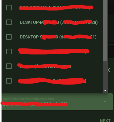

I have been on a mission to clear up old abandoned entities attached to my Unifi Network. Mistakenly started here but finally found this thread and a thanks to a long read and the work of the addon authors I found out how to Enable a dead entity, restart, then delete that entity. That got rid of fifty… but still have three left. All are Windows laptops that have been on my house network and now gone.
I managed to get them Enabled fine, but the delete button will still not light up.
I assume that is because these are also in this list
So how do I take these three “network clients” off of this list?
Or do I need to “create entities from network clients” so I can then delete them?
And checked - these are not listed on Unifi Network Controller itself. So not sure where they are coming from.
My network changes a lot. Often have devices connect for a few days, then gone to never been seen again. I would love to have a way to setup an automation to say “delete entity if not seen in a week”.
Take them out of your UNIFI controller. They should show up as your offline clients. Once you do that, after a few synchs in HA, they will start getting listed to a point where you can delete them in HA.
AHA!! I’ll delete my other reply… only just found the ALL filter.
Thanks for poking me to look there again. I had looked before, but didn’t notice that drop down list that showed “1D”. The fact my laptop was not showing up as offline got me poking everything… and finally found these pesky items hiding. Didn’t realise “1D” meant a “1 Day” filter.
Once they were removed there, they disappeared from HA. Perfect.
I now have to find some way of automating the cleanup.
