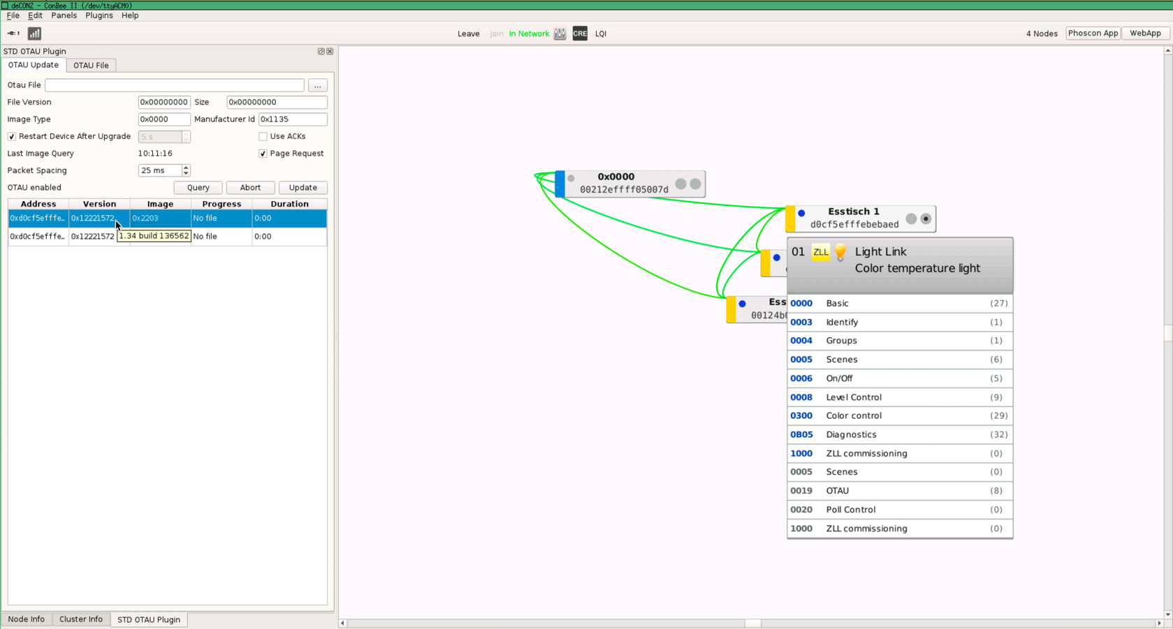

I just went into the VNC view again and tried the update process again. From the moment I clicked “Query” it took a full 10 minutes (!) until the Version column of the selected node changed from 0x00000000 to a meaningful hex address and the node info became available. I have no idea, what deCONZ does in the meantime.
Hmmm… Indeed I had all debug options enabled in deCONZ configuration, I hoped this will help to get OTAU related messages in the log. So I removed these and restarted plugin… not much change, perhaps less messages, but stil pleanty of these with no reference to OTAU :frowning:
Regarding running query; it is starnge, I tested it on every single node and for all nodes that are permanently powered on (e.g. bulbs I have instant responce with updating version (e.g. change from 0x00000000 to 0x12214572… yet hovering mouse over this value hints newer version is available…
Just for completeness: Here is a screenshot of my VNC view after marking the first IKEA bulb, hitting Query and waiting for about 10 minutes. After that the second IKEA bulb updated instantaneously when I marked it and clicked Query again.
