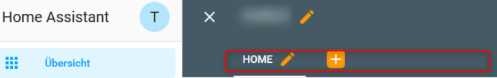

Where are configured the view in lovelace ?
First enter “Configure UI” mode via the three dots at the top right. Then click the edit icon next to a view:
screenshot
