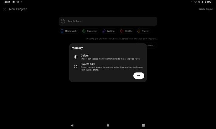

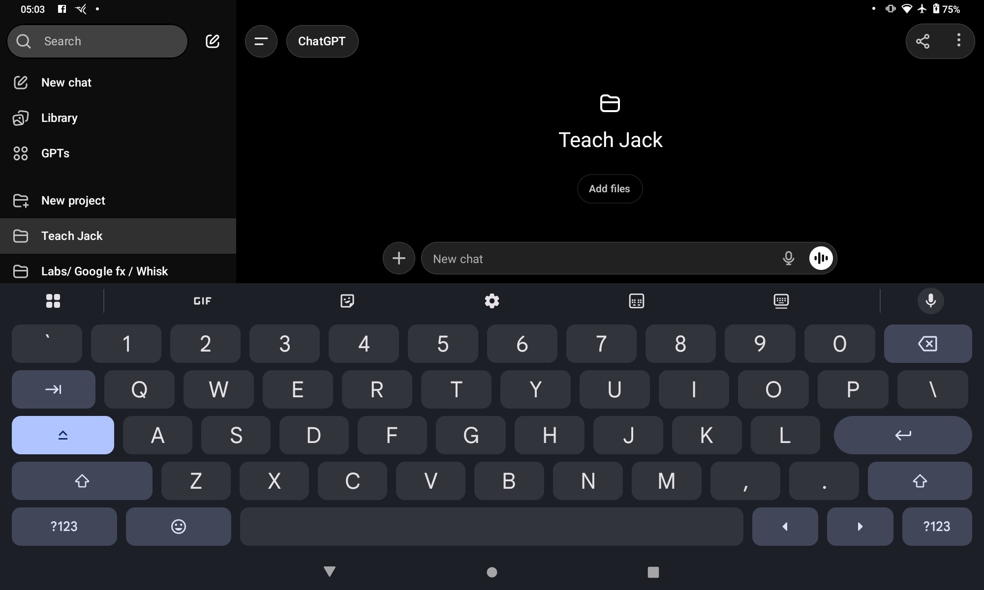

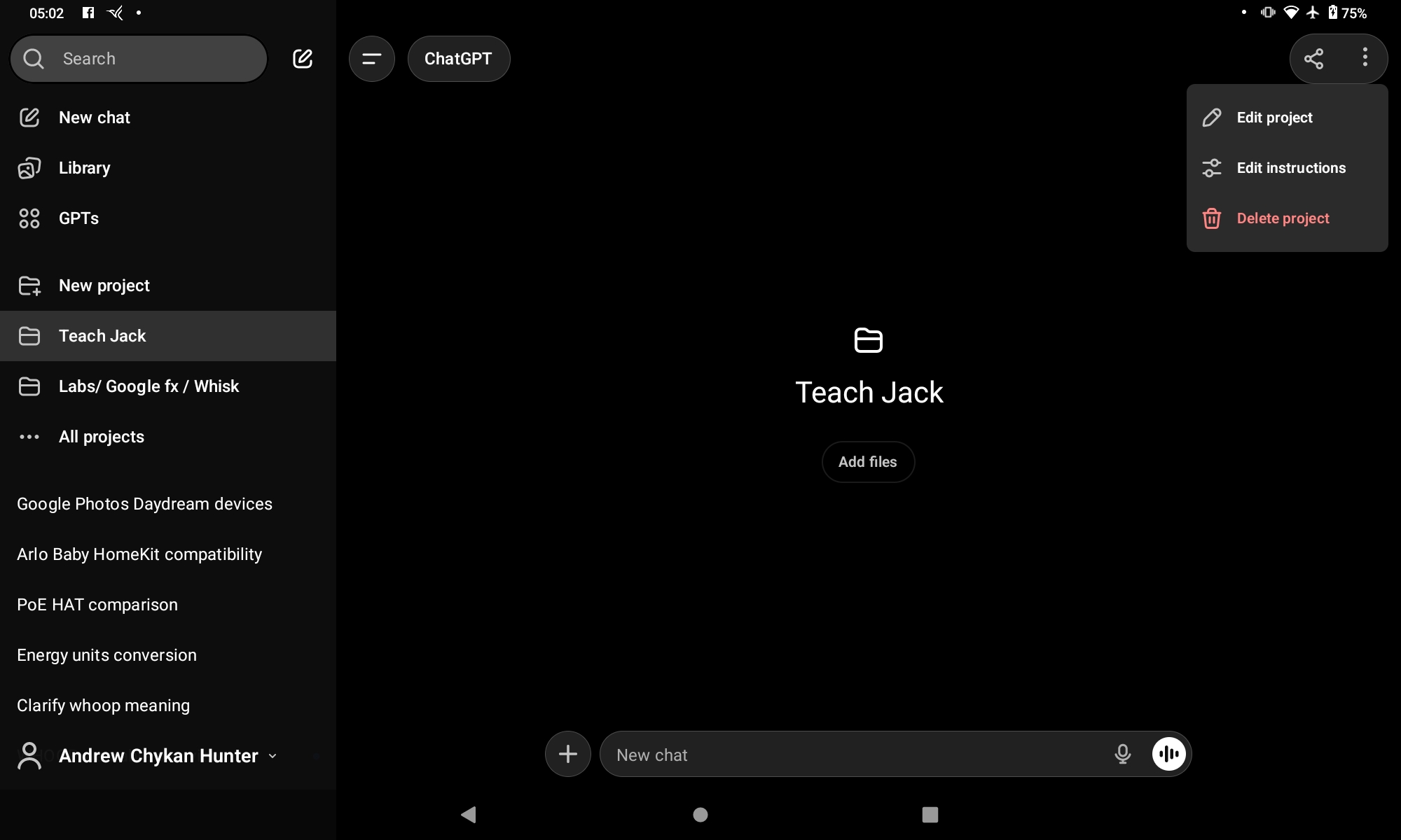

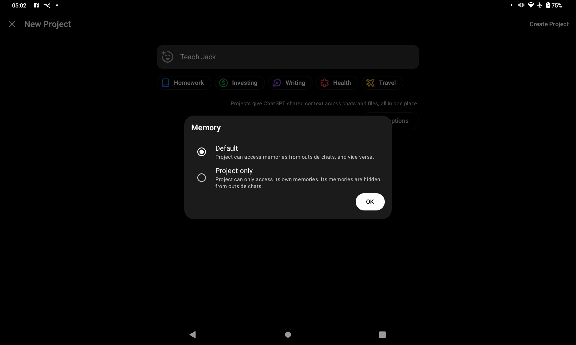

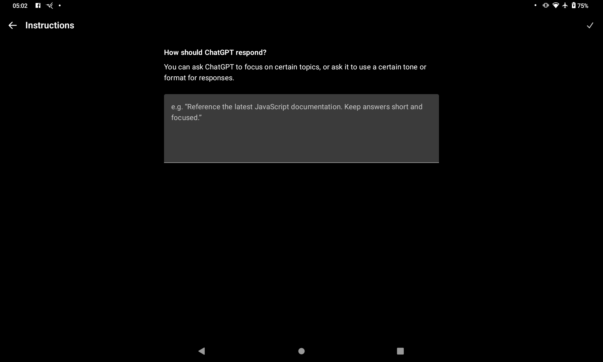

  1. Locking items in memory. During chats when it has something right I request it to lock the code in memory as the canonical file. This tends to prevent drift and it placing older code in that you have already fixed. (Also ask it to delete old canonicals)
  2. Locking anti hallucination prompts into memory is a must. Tell it exactly what you want, ask it to cite sources, ensure each response has a confidence rating, all yaml must be cited from we sources, do not make up code or hallucinate.
  3. Uploading files to projects and reminding chat gpt that the files are there helps. Also providing a good prompts in each project.
  4. Construct each question carefully, exact output you want, only change a certain bit of code and touch nothing else, give an example.
  5. Check each response carefully, it is capable of managing quite large block of code especially in canvas mode. You can also ask it to execute python etc.
  6. Providing it with errors codes on failed attempts also helps it rectify mistakes quickly.

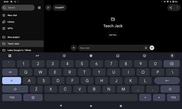

Could you clarify how you are accessing ChatGPT?

@jackjourneyman I pay a AUD $20 per month subscription to Chat GPT.
Rather than dismissing the technology I decided to embrace it so I did not get left behind. Even though I am a bit old school and still have a fax machine and an abacus.
Knowing how to use it as a tool will keep us ahead of the kids of tomorrow.

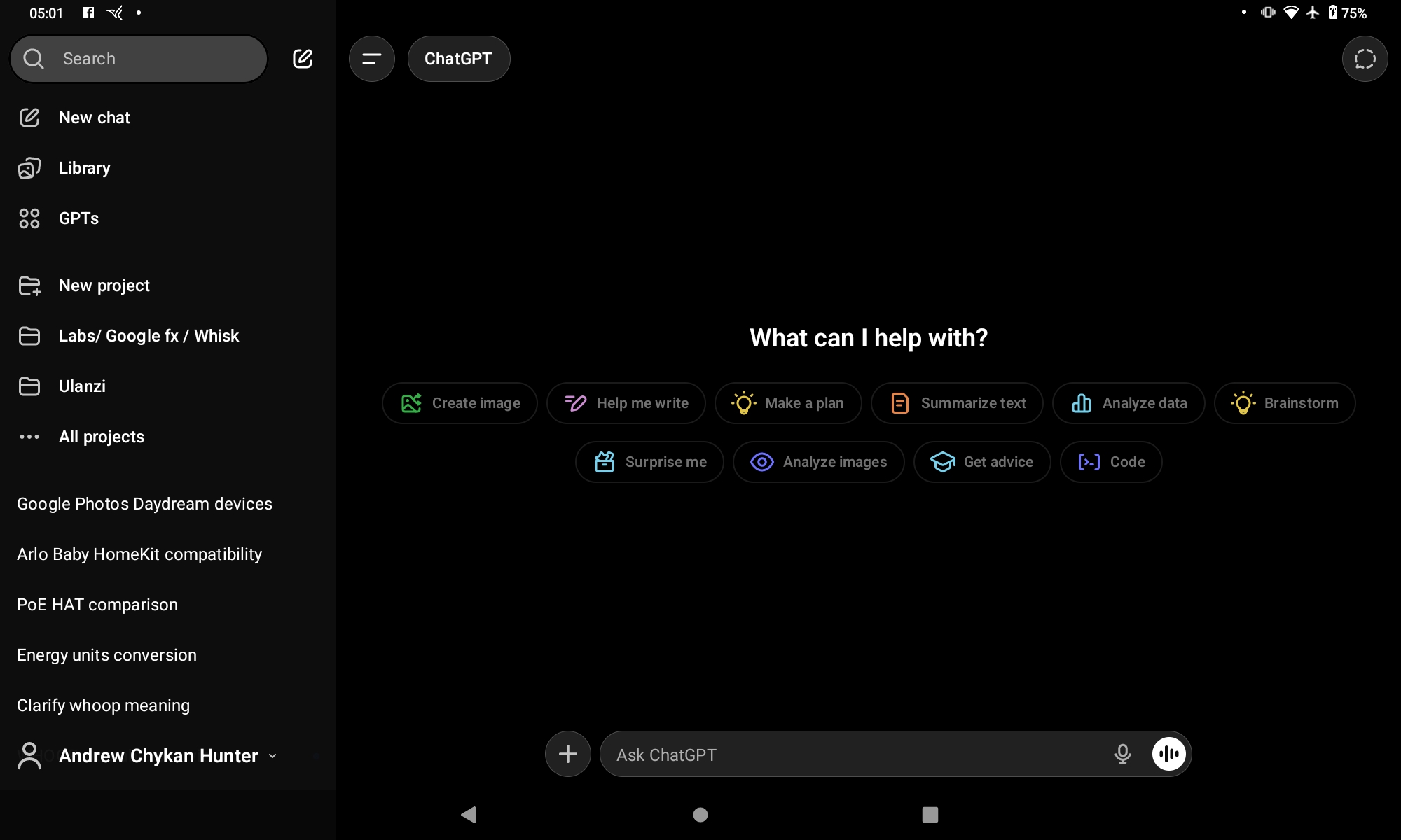

Still not clear how you are accessing ChatGPT. Your Readme on GitHub mentions the Windows app - is the “attach file” option available on the free tiers?
Add project. Side Bar
I have the paid version but this will work with the free version as Projects are now included with all versions - free and paid.
