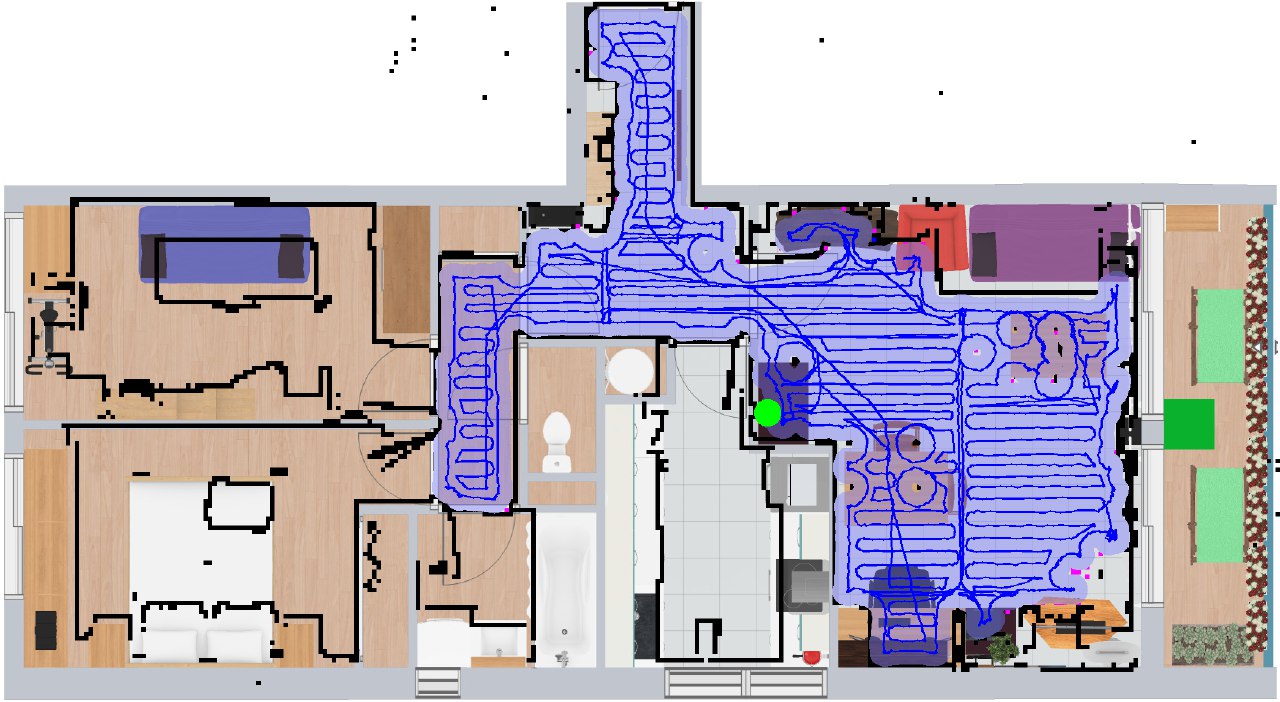

I’ve been working on drawing vacuum map on overlay of my flat plan. It requires a rooted robot
Here is the result :
I’ve made a script on HA that starts on robot state change, grab log and map via SSH and draw that locally on HA. Then use the built image as a generic camera.
The script stops when vacuum is docked and send me the final image on telegram.
I’m working right now on making it more generic ( optimize placement and scaling between the 2 images, etc. …). As soon as it’s stable, i’ll share my config on github.
EDIT: I created a dedicated topic : Xiaomi Vacuum (rooted) live map with floor plan

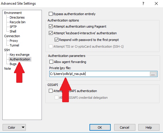

I use WinSCP on my PC for this part. If you want to do this part on Linux or Mac you will have to google or wait for someone else I am afraid.
On the Left Select “SSH” and then “Authentication”. Under Private key file: navigate to you id_rsa.pub fiile.
It will ask about converting the file to a “PuTTY” format, select OK, OK again.
I then select save on the first screenshot. Press Login and it will prompt you for a password. This will be the one you set when setting the key up.

I followed your advice but is not giving me this dialog box … just asking for the password, I put it but it says is wrong (I am pretty sure is the correct one, but will redo the whole process just in case)
Winscp upgraded to latest version 5.13.6 (9061)
On my first screenshot where you put the username root in are you leaving the password blank? It should ask you for the password later on once it starts connecting.
