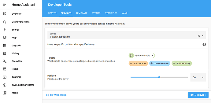

ok, I was able to answer the question for the automation myself: there is a service, which can be called.
But how do I get the slider onto my dashboard?
After some research and some try and error, I got this to work. Finetuning still necessary, but looks very good so far.

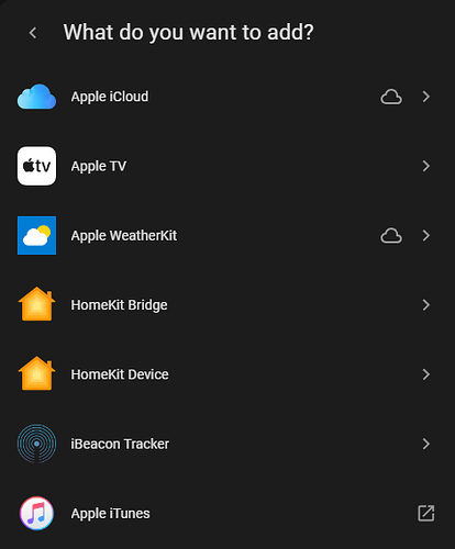

@schneich let me make sure I’m doing the integration correctly then. I’ll show you my steps and you tell me what is wrong.
I click add integration and type in homekit. This comes up:
I click on Apple and get this:
I choose homekit device and then get the message I posted previously.
What would you suggest?
Sorry to make another post, I didn’t see this until I replied to your other post. They are on separate vlans but at the moment they both see each other. The IOTs haven’t been separated yet. I will look up HOME ASSISTANT CANNOT DISCOVER MY DEVICE tonight and see what that suggests. Thanks for the suggestion. BTW, HA does see all of my other IOT devices that are on the same vlan/wifi as the velux windows and blinds.
I don’t know the integration very well. I am only a user as you are. :slight_smile:
Your error message says: no unpaired device…
I assume, because you paired your device with your phone, it is not free.
Technically the windows and blinds are paired to the KIG 300 and then the Velux Active app was install on the phone which communicated with the KIG 300. Do you have any idea whether I should remove the app from the phone or unpair the devices from the KIG 300?
Well, I don’t know. Unpair your device (KIG) and check, if it pops up in HA.
I removed the gateway from the phone app, closed the app, reopened it and it took me right away into setup asking for a gateway. I then deleted the app. I tried the integration again in HA but it still says there are no unpaired devices. I suppose my only option now is to unpair the windows and blinds from the KIG 300.
I just found another post explaining how to set up the KIG 300 without an apple device: Integrating Velux Active (KIG 300) into Home Assistant My only concern is how to unpair the windows and blinds from the KIG 300 without accidentally unpairing the remotes from the windows/blinds. Two of our windows are so high I’d need to get the installer back on the roof to reconnect. I’m going to post on the above link to make sure I make no mistakes.
