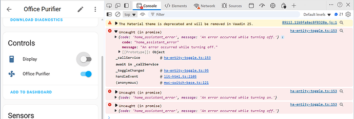

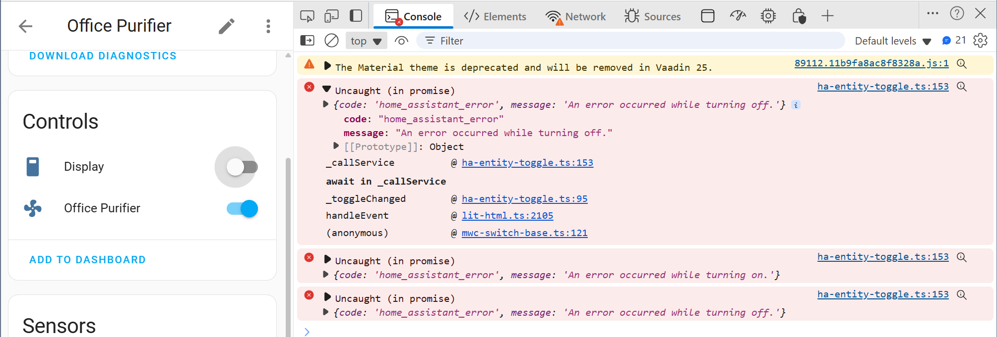

That said @cdnninja, I just upgraded to that version and toggling the Display control and it simply dumps a generic “An error occurred while turning [on/off],” but only when toggling the Display feature. Turning the purifier itself on/off still works fine.
For reference, this is an LV-PUR131S.
Edit: Looked a little deeper in logs and found this, if it helps. Turning the whole purifier on/off did work most of the time, there were a few failures. The new display toggle, however, never ever did work for me since the upgrade.

Following up (since I cannot edit my last comment)… I found the cause of the fan speed bug and created an issue here: VeSync: Fan controls do not work on LV-PUR131S (potentially other models) · Issue #147252 · home-assistant/core · GitHub

Ah yes, the display side. I had forgot it does fail on just that model(131). I had opened this as it is a library issue not HA:
fix: 131s display by cdnninja · Pull Request #305 · webdjoe/pyvesync
Display state works in my re-write version but that needs a good bit more time before released so I reopened the PR for webdjoe to review.
Should be fixed in 2025.10 beta. Please give it a try.
